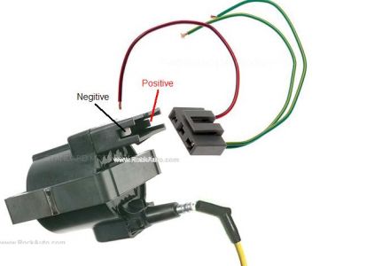

I don't exactly understand how to do that obviously the battery has to be hooked up so the wires to the coil have to be hooked up so how do I hook up my voltage meter it has two wires and a digital reading so were do i put both them to check the negitve side of the coil and the positive side of the coil.
and how do i do that with the coil connected i will give picture to explain.

Ok what you need to do is have every thing hooked up as you have already said, the batt and the coil. Then take you Volt Meter and put the possitive side of the volt meter to the wire and you can back probe it and then the neg to a good ground like the intake and take a reading with the key on engin off and do the same on the neg side of the coil and take a voltage reading there and let me know what you find.
