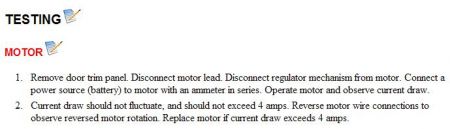

sirs. how do i check to make shure the window motor is good/bad? the switch on the drivers side is a duel window switch. it works for the pasinger window but not on drivers side. is there a way to check the switch/motor?? am disabled a bit so if you would you make directions kinda easy please. charles

if motor tests good then suspect faulty switch..
https://images.2carpros.com/forum/automotive_pictures/261618_Noname_864.jpg
