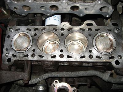

I have a 1997 Ford Aspire, 5-speed manual transmission, 90,000 miles.

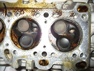

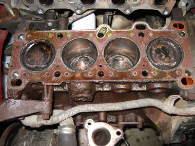

At my last oil change, I observed oil in my coolant expansion tank. No coolant appears in the oil. Since this is the case, I assume that the oil is under pressure where it is leaking into the coolant. Having said this, I suspected the head gasket was cracked where the pressurized oil makes its way to the top of the engine. I pulled the head only to find no obvious head gasket cracks or stress. The head and block, where they meet, looks good too.
I am stuck. Should I replace the head gasket not knowing if I caught a head gasket going bad very early or replace the head and gasket? I guess another consideration is that the block could have a problem around the oil pump?
One final thing to add. Over the winter when the car sat for more than 10 hours, one of the hydraulic tappets in one of the rocker arms sounded like it was sticking. After re-starting the engine several times when thus happened, the tapping would go away. This happened 8-10 times. (Probably not related to the oil in coolant?)
HEEEEELLLLP. Thank you, Doug

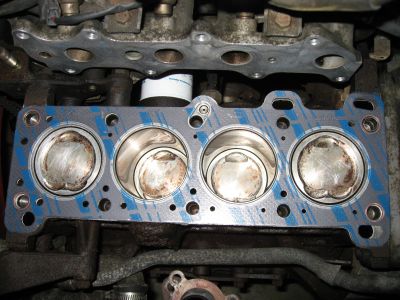

Replaced the head gasket and all eight valve tappets. 400 miles later, sounds and looks good. Time will tell.

Now at 98,000 miles, I have found oil in the coolant tank again. I am at a lost. The machine shop pressure tested the head, when it was shaved. I replaced the head gasket and torqued the head bolts properly. That was a lot of work to still have the same problem.
what to do... what to do?

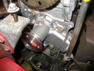

>is it possible its transmission fluid from the radiator transmission cooler? I should have mentioned in my first post, the vehicle has a manual tranny with no oil or tranny cooler in the radiator. I did re-use the head bolts... but was told this is fine since they are not stretched to hold torque. Funny thing is, Chilton's says to replace with NEW bolts and other repair guides don't specify. The oil that I am finding in the expansion tank and filler neck is not a lot. See the photos of the head and block (before and after.) How about the oil pump? Is there any way at all that the oil pump could be leaking into the coolant?

there could be a bit of oil in the system that is still working out, try a whole cooling system flush.
the bolts could be loosening up, try retapping the wholes and redie the bolts and use a spot of locktight on them when reinstalling
also use rtv sealent on the parts of the gasket near the manifold.
