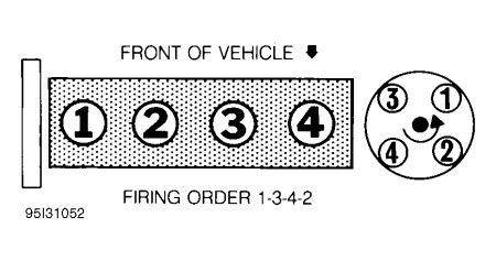

The Plug wires may have been mixed up and I don't know the order on the distributor cap and I don't know the cylinder numbers from left to right, standing in front of the car. Please help.

https://images.2carpros.com/forum/automotive_pictures/261618_Graphic_749.jpg
