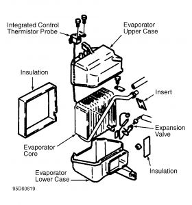

Air Conditioning problem
1995 Ford Aspire 4 cyl Two Wheel Drive Automatic
Where is the expansion device/orifice tube located on my 95 Aspire with factory air?

https://images.2carpros.com/forum/automotive_pictures/62217_aspire_1.jpg
Removal Remove evaporator core. See EVAPORATOR CORE . Disconnect equalizer line from evaporator core outlet fitting. Disconnect expansion valve at evaporator core outlet and inlet fittings, and discard "O" rings. Remove expansion valve.
