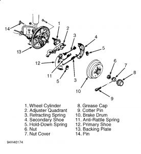

I would like an image of how to set the different components of the rear brake system, especially the springs.

Here you go maybe a bit small
https://images.2carpros.com/forum/automotive_pictures/198357_Grafic_3_56.jpg
