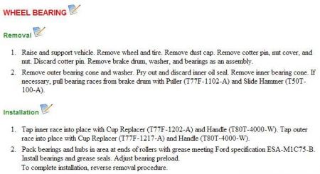

How do you change the REAR wheel bearing on a 94 aspire?
i need a diagram

https://images.2carpros.com/forum/automotive_pictures/261618_Noname_1678.jpg
