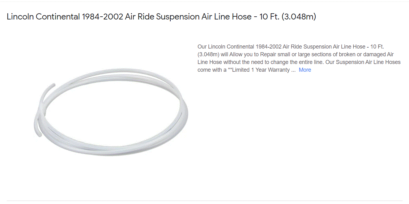

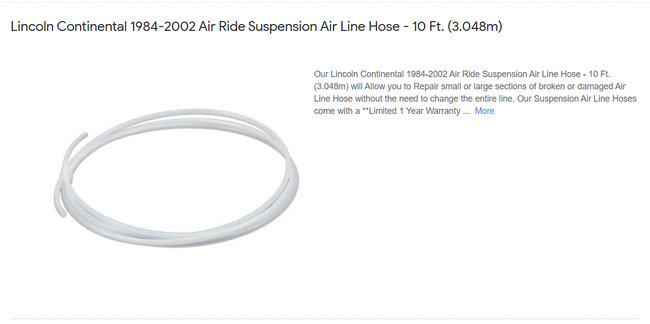

After a lot of research, I found it. LOL It's 1/8". If you go to this site, you will find replacement hose. I have no idea why it wasn't in any of my manuals, but it wasn't.
https://www.google.com/shopping/product/1?q=1996+lincoln+continental+shock+air+hose+kit&prds=epd:1918564353536903019,prmr:3,eto:1918564353536903019_1,rto:1,pid:1918564353536903019,tpim:COCWr8aclZ7pLxCBjJfYxYDrw-UBGPDg-AoiA1VTRCjwzYWNBjCti-Qy&utm_medium=tu_prop&utm_content=eid-lsjeuxoeqt&utm_campaign=106497453
See pic below. 3.048mm is equal to .12". In fraction form, which is 1/8"
I hope this helps. Let me know if there is something I can do to help you.
See pic below.

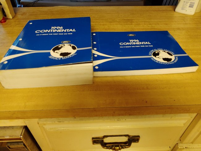

Thanks for that Joe. Just got a shop manual from US used.

This manual is the most detailed manual i have ever seen at $60.00 is a deal! Okay bud, byes fer now.

Yep, that's a dealership repair manual from Ford. Did you get things back together yet or are you still waiting for parts?

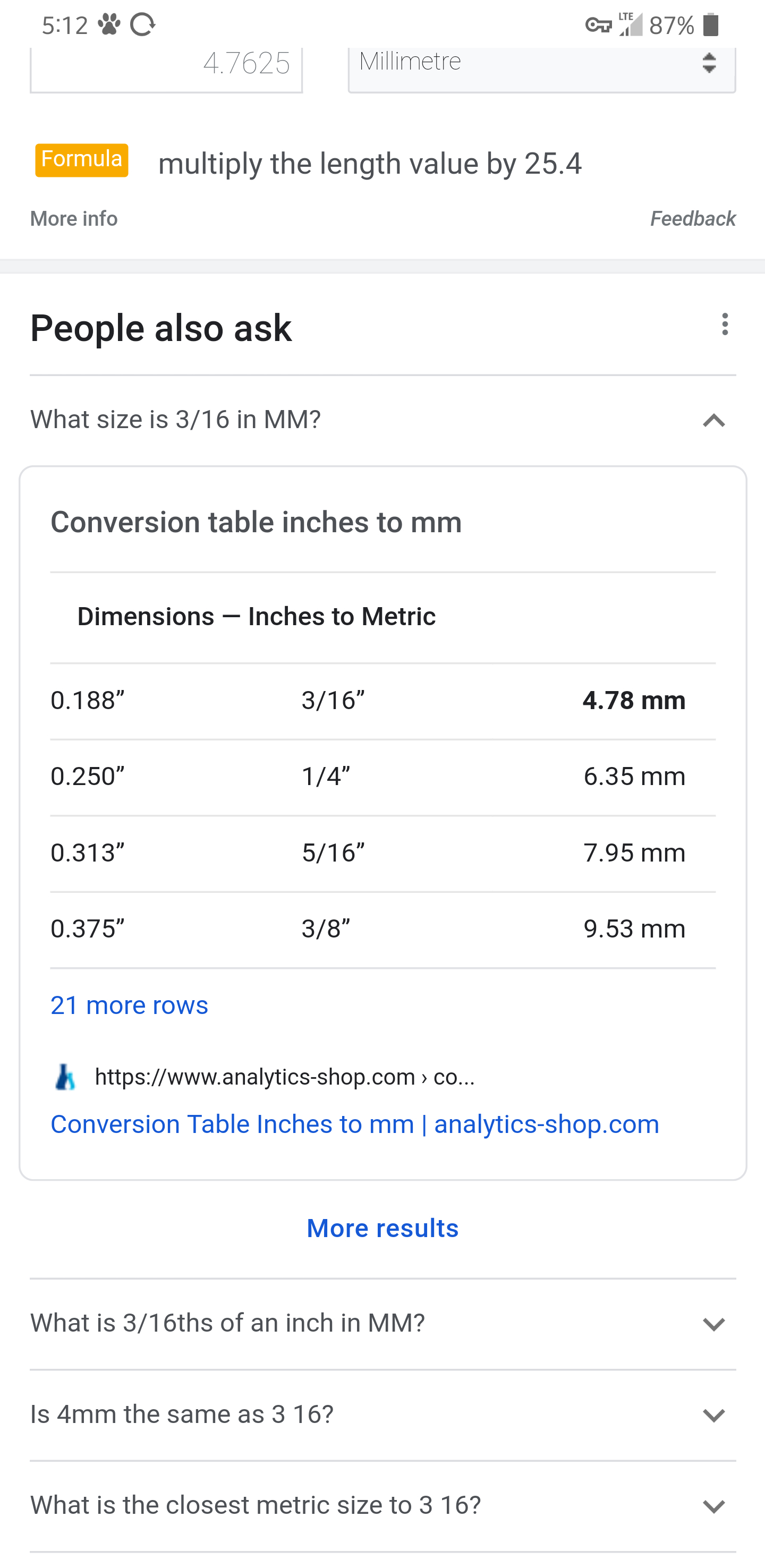

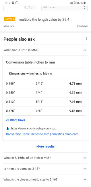

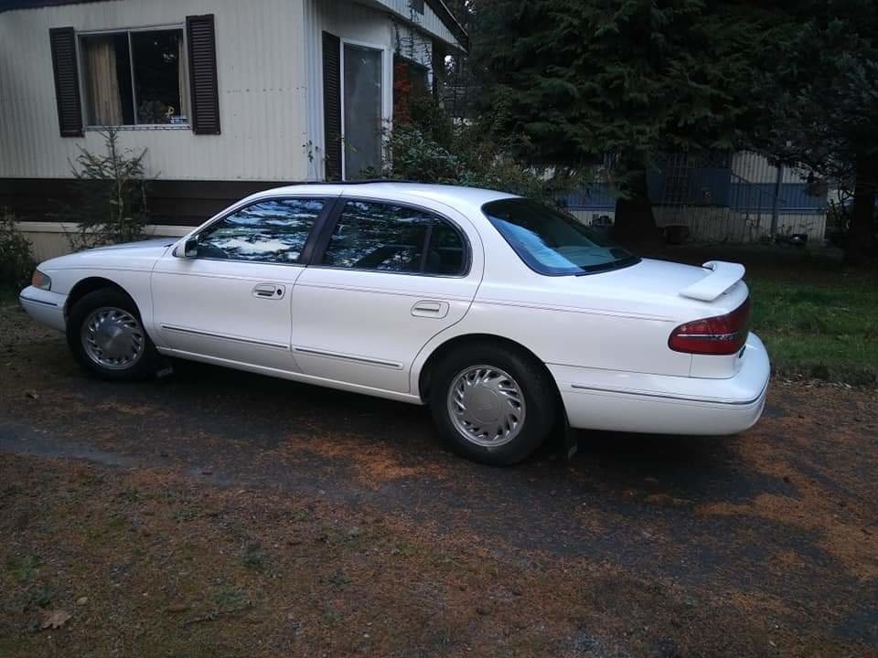

Few pics FYI. Note: airlines 4.7 mm - .188 in - 3/16 th.

The car looks great. I had an 89 MarkVIII collector's edition. I sold it about five years ago and regret it. My father bought it new and gave it to me before he passed. I wish I had them both back. LOL
I live near the east coast, and a person from CA saw it on craigslist. He flew here and drove it home. LOL
Regardless, thanks for the update on hose size. I was going off what I was able to find based on year, make, and model.
