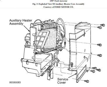

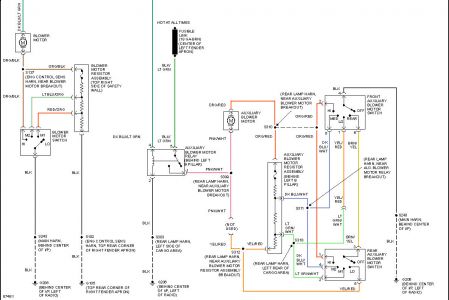

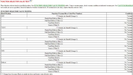

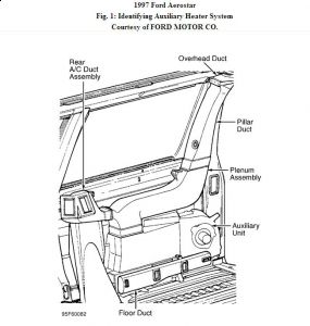

Car just seemed to be taking in only cold outside air and overpowering heater cores. Removed outdide grill that runs accross bottom of windshield and along hood.Removed and found fresh air intake opening. Sealed hole by compressing large sponge and inserting into opening.Front heat now working at about 80% of normal which is pretty good. Rear air still same(slightly warm at low air speed)Does rear air have fresh air intake also? Sounds like a damper/s issue.Any ideas. Cannot find any diagrams of ventilation or heat controls....Jim
Jan 9, 2010 at 9:27 AM
SERVICE WRITER
  • 9,123 POSTS
I still think there is an air pocket in the cores. Remarkable how much the temp came back for you by blocking off the air intake duct.
https://images.2carpros.com/forum/automotive_pictures/30961_aero_2.jpg
https://images.2carpros.com/forum/automotive_pictures/30961_aero1_2.jpg
I'll look for the info you requested and update when I do.

SERVICE WRITER
