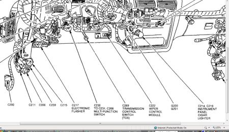

Where is the turn signal flasher located on this vehicle?
Friday, May 28th, 2010 AT 11:04 PM
MECHANIC
75,992 POSTS
The Electronic Flasher is located at the Behind LH side of instrument panel, on front of fuse panel.
