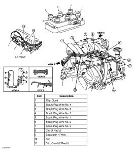

HOW DO I CHANGE THE SPARK PLUG.
FORD AEROSTAR 6 CL 2 WHEEL DRIVE AUTOMATIC.

trace the plug wires back from top to each plug pull wire off each plug in turn and using a spark plug wrench unscrew plugs ... replace with new ... replace wire/lead by push clipping back onto plug .. do this for each plug in turn .. do not get the wires/leads mixed up ??
https://images.2carpros.com/forum/automotive_pictures/266999_spark_1.jpg
