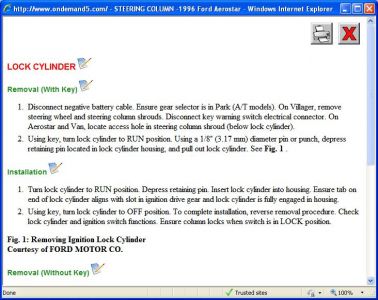

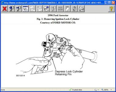

I need to know how to put a new ignititon switch so that way I don't need to use a flat head srewdriver??

https://images.2carpros.com/forum/automotive_pictures/416332_1996_ford_aero_star_lock_cylinder_part1_1.jpg
https://images.2carpros.com/forum/automotive_pictures/416332_1996_ford_aero_star_lock_cylinder_part2_1.jpg
There you go.
