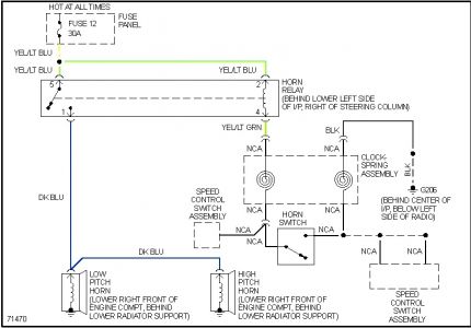

what do i have to check to fix the horn. Can I get electrical schematic of this model.

You can check the fuse. The horn switch is a ground for the coil side of horn relay.
