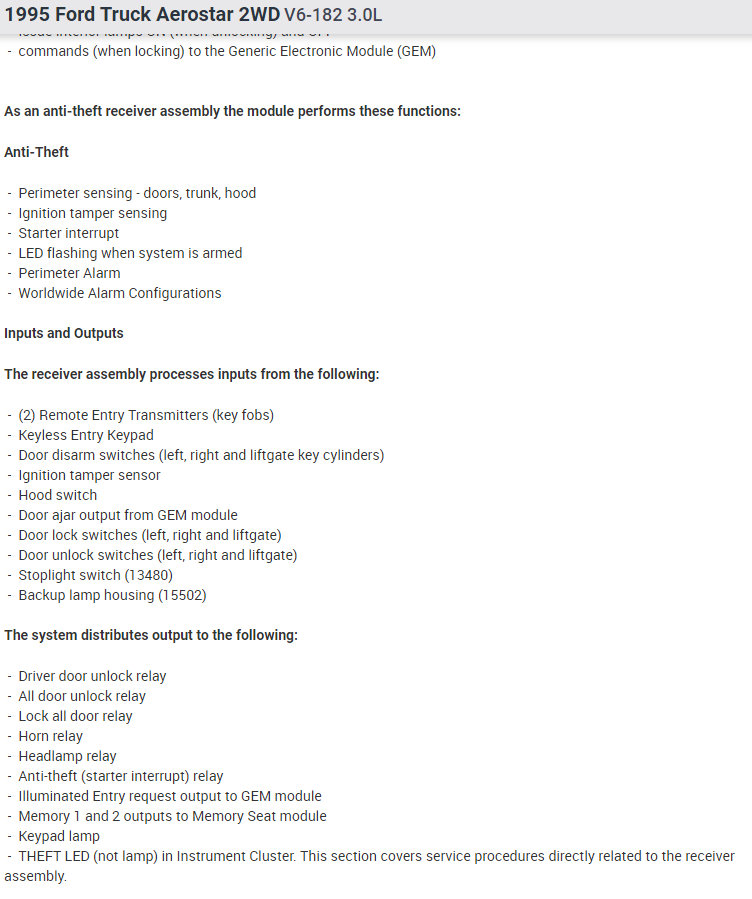

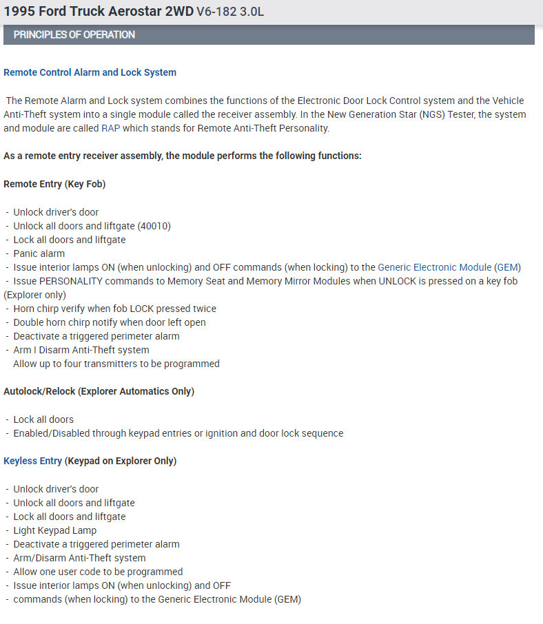

On these vehicles you can reset the security alarm system.
Just disconnect the negative battery cable and wait for a minute.
Reconnect, it should reset the system.
You can also try this method:
Press down the panic button for 2 seconds. Close all doors and use the key to lock and unlock the driver's door. This should reset the system as well.
Here is a helpful article of resetting security system:
