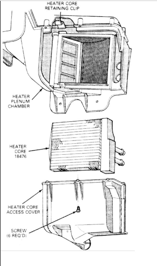

i can't get my heater to warm up. the hoses both seem warm but i only get cold air to come out. i think maybe i need the to change the heater core. i'm really not sure.what is the best way to remove the heater core?

On this car is is easy just remove the heater hoses and the rear flap door and the core will come out here are two guides and a diagram (below) that will show you how to do the job and troubleshoot the heater.
https://www.2carpros.com/articles/replace-heater-core
and

Thanks you the heater core was plugged solid super heavy lol the heater works great :)
