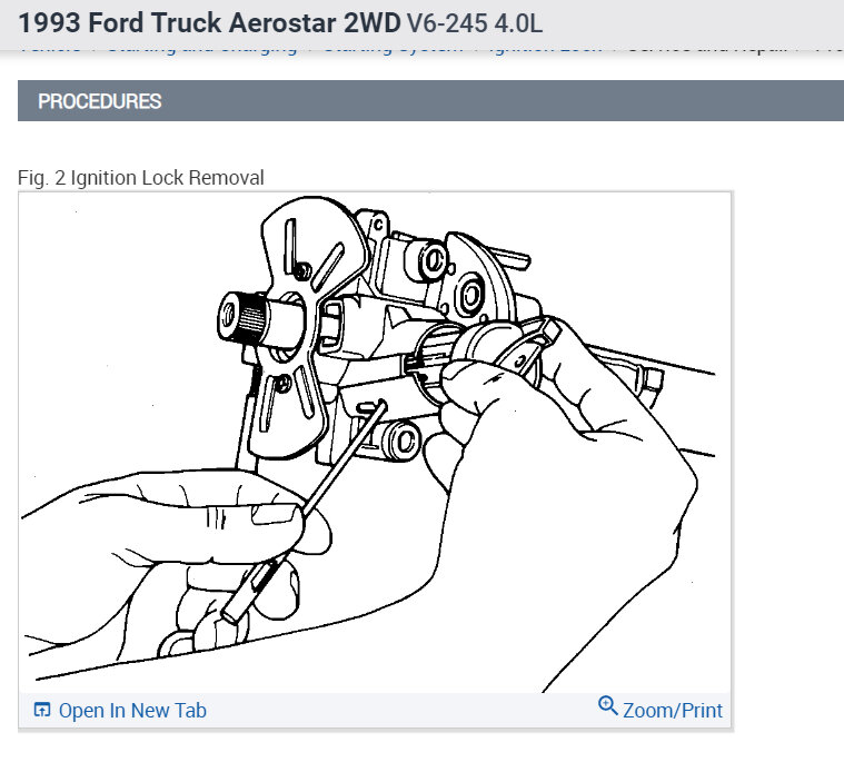

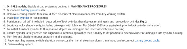

how do i remove ignition lock cylinder?
1993 FORD AEROSTAR

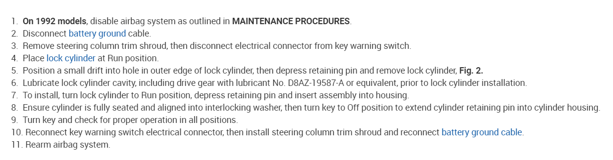

The following procedure pertains to vehicles that have functional lock cylinders and ignition keys. Check out the images (Below). Please let us know if you need anything else to get the problem fixed.
