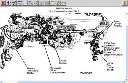

I heard my van has a fuel shutoff switch. If there is where would it be located?

The Inertia Fuel Shut Off Switch is located behind the Passenger kick panel

Inertia switch is behind the right kick panel-see below
https://images.2carpros.com/forum/automotive_pictures/12900_inertia_2.jpg
