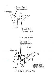

I am replacing the original alternator. At the same time, I am replacing both drive belts. I have the power steering belt on and tight. But, I am running into issues with the longer serpentine belt. I know it is the right size belt since I matched it up with the belt being replaced. I believe my problem is just the routing of the belt.
I have a Haynes book for the year/model, but it's diagram leaves a little to be desired. Worst case, I will stop somebody driving a similar Aerostar to look inside the engine.
Appreciate your help.

engine size ????
engine size
and I will try to get you the diagram

Oh, I'm sorry, V6 3.0 Liter. Thanks for your help.

hope that help
https://images.2carpros.com/forum/automotive_pictures/99387_beltaer_1.jpg
