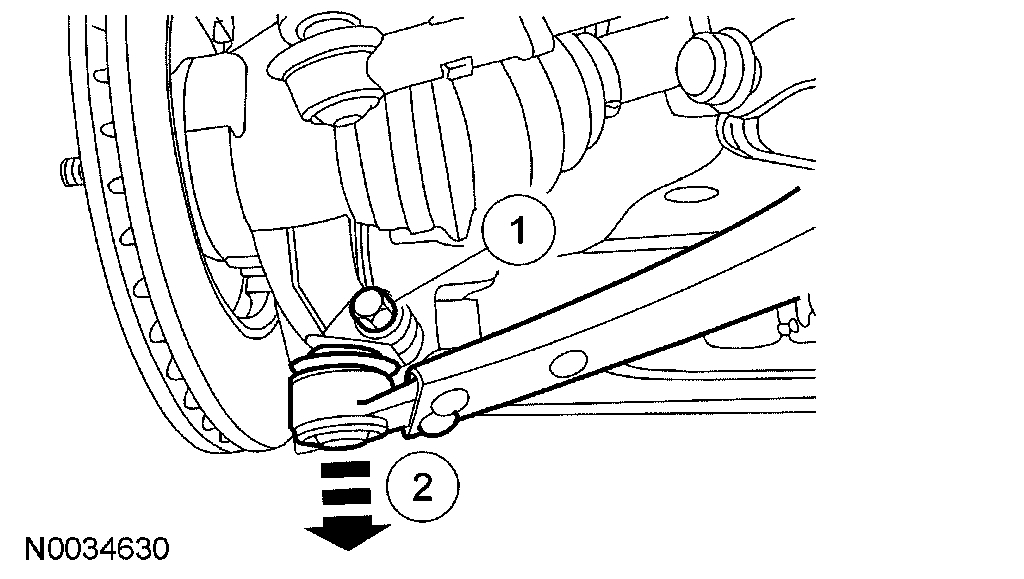

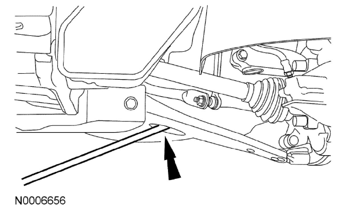

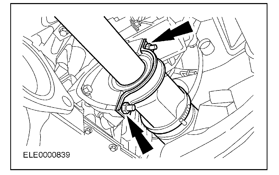

I think it is the CV axle. there's no clicking when turning the wheels like I would expect if the CV axle was bad.. if I'm going down the road and it starts shaking I put the car in neutral and it goes away. so it's the CV axle right? The boots are in tact.. I just bought the car and it had been sitting for a while before I got it. can you add some advice?
Dec 5, 2020 at 6:04 PM
I suspect you are correct but just because the vibration goes away in neutral does not mean it is a CV axle. It means that it is something in the drive train which is what you are unloading when shifting to neutral.
Here is a guide that will help with this a little bit more:
https://www.2carpros.com/articles/steering-wheel-shakes-when-accelerating-or-braking
I would suggest trying to find all the ways that it does do it and does not. Meaning if you accelerate harder or slower, let out of the accelerator at different times when it is doing it, does it stop or get worse?
I understand you have no clicking but we just need a little more info on when it does it and when it doesn't then we can feel better about doing the axles.
If you want to remove the axles and check them here are some guides but it is a bit of work just to check them:
https://www.2carpros.com/articles/replace-cv-axle
https://www.2carpros.com/articles/how-to-replace-a-cv-axle-bearing
Let me know what you find with these other driving styles and we can go from there. Thanks
Dec 5, 2020 at 7:16 PM
  • 110,194 POSTS
If you find it stops when you place it in neutral, then we know it is most likely something with the CV joints, a bad wheel bearing, or even a motor mount.
Is there any noise associated with this when it happens? Does it happen always when you hit that speed?
I ask because one would think a bad CV joint wouldn't care what the speed is. I have dealt with tire balance that is noticeable only at specific speeds, and yes it may be less noticeable when you place it in neutral. Have you had the tire balance checked? Since it was sitting, are you sure there are no flat spots on the tires? Also, check for a possible bent wheel.

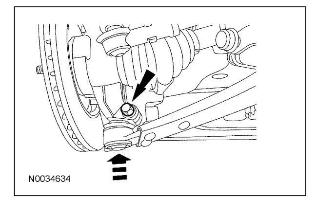

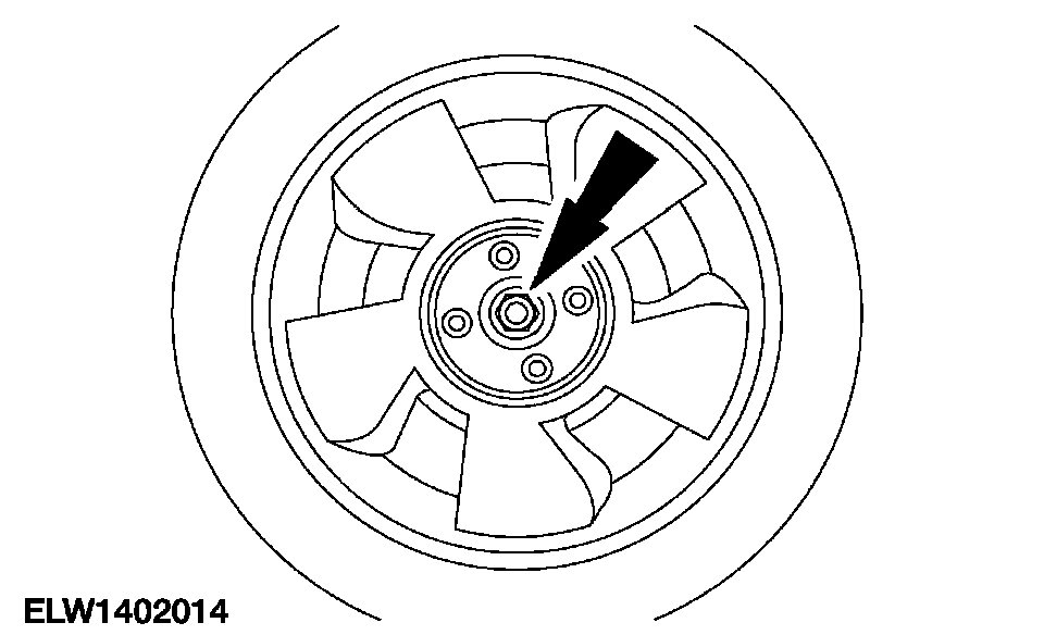

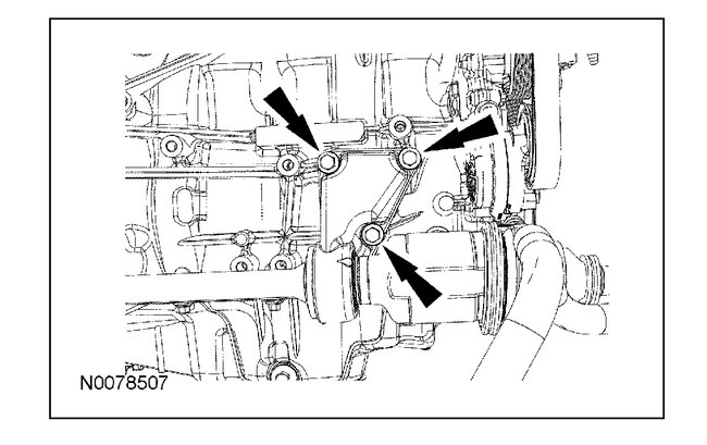

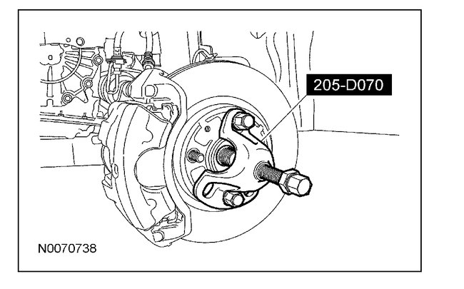

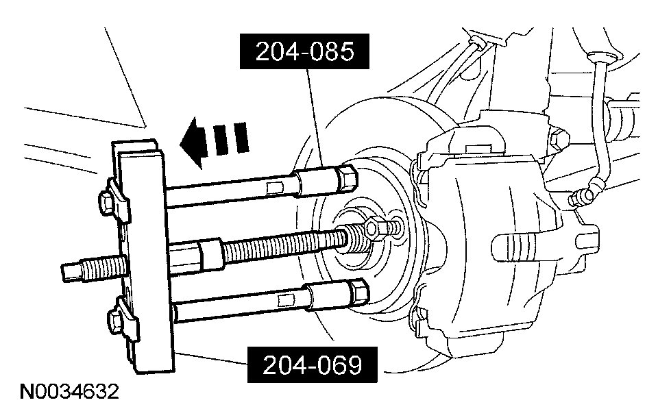

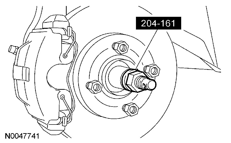

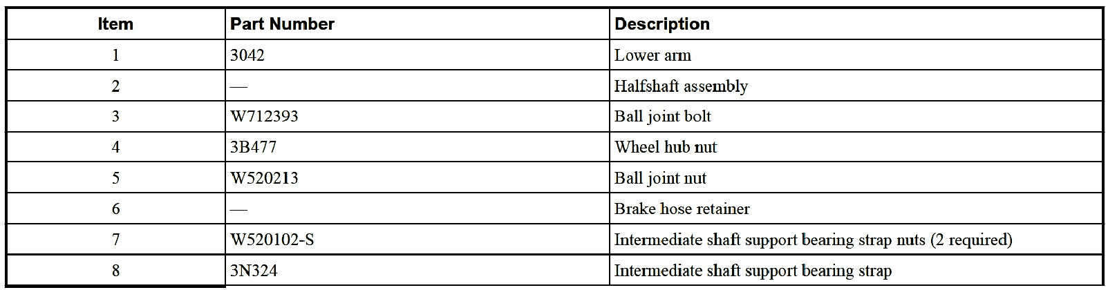

As far as the CV axle, if you decide that is the issue, here are directions for replacement. It is broken down into left and right sides. I will start with the right side. The attached pics will correlate with the directions. Also, note that there are specific variations between automatic and manual transmissions.

pic 1

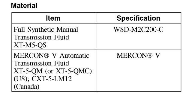

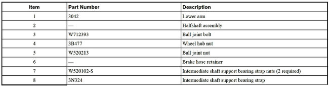

Material
pic 2
pic 3
pic 4

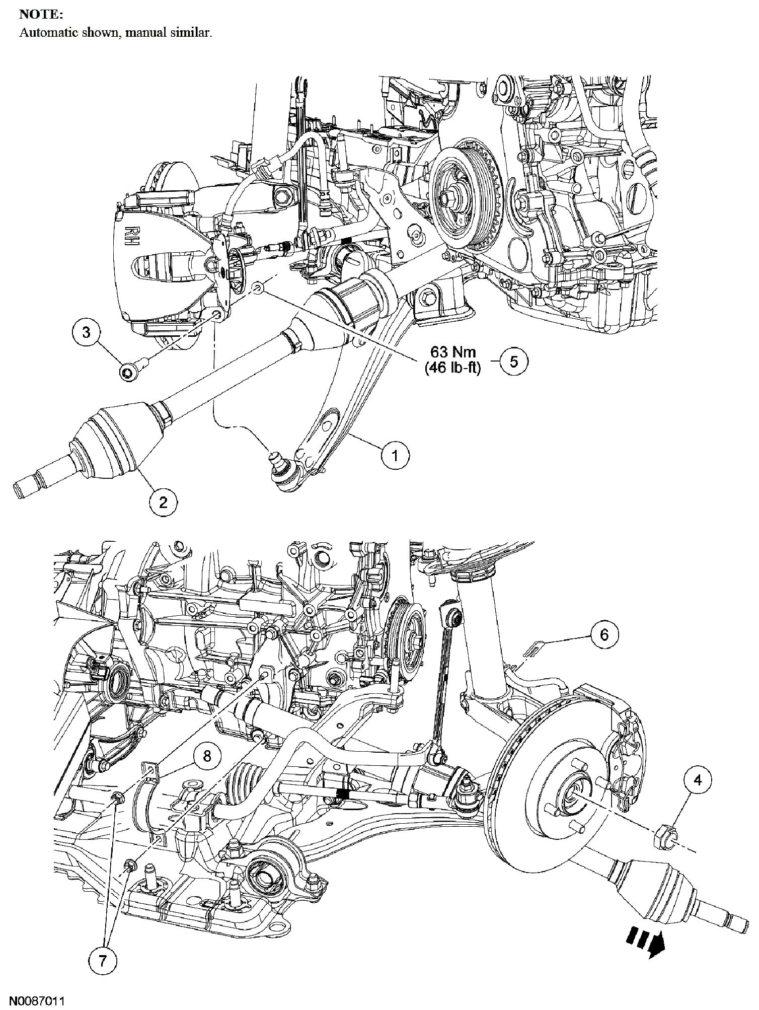

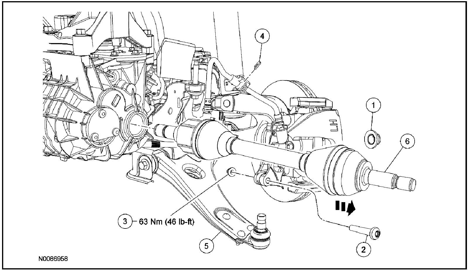

Removal
1. With the vehicle in neutral, position it on a hoist.
2. Remove the RH wheel and tire.
3. Remove and discard the wheel hub nut.

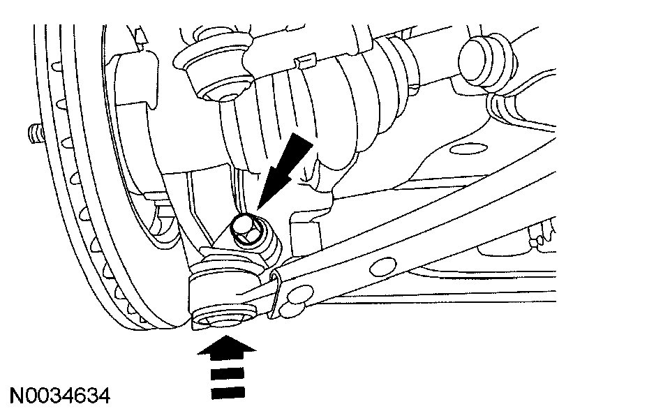

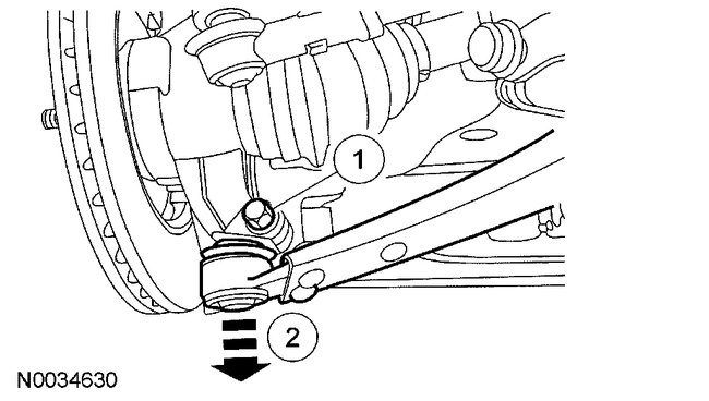

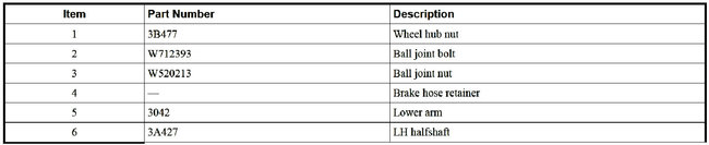

4. NOTICE: Do not use a prying device or separator fork between the hall joint and the wheel knuckle. Damage to the hall joint or hall joint seal may result. Only use the pry bar by inserting it into the lower arm body opening.
NOTICE: Use care when releasing the lower arm and wheel knuckle into the resting position or damage to the hall joint seal may occur.

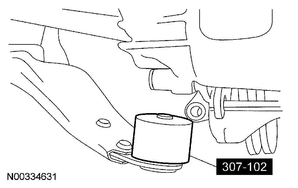

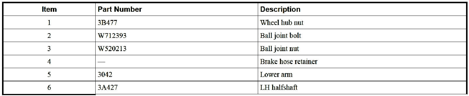

Remove and discard the ball joint nut and bolt.

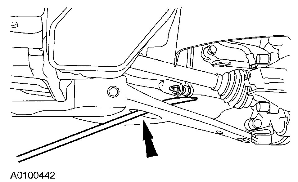

- Insert a pry bar in the lower arm body opening and separate the ball joint from the wheel knuckle.
pic 5

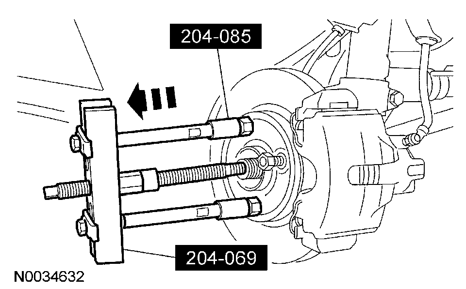

5. NOTICE: The inner joint must not be bent more than 18 degrees. The outer joint must not he bent more than 45 degrees. Damage to the half shaft will occur.

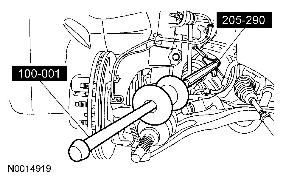

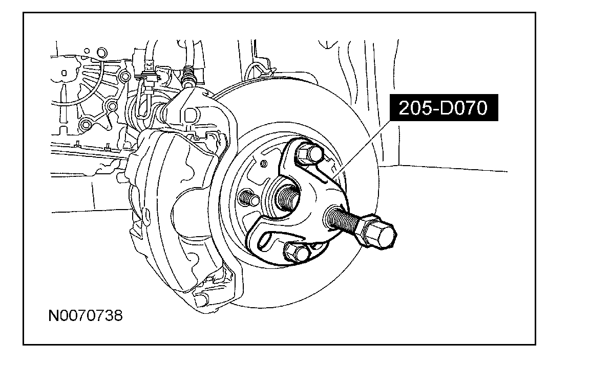

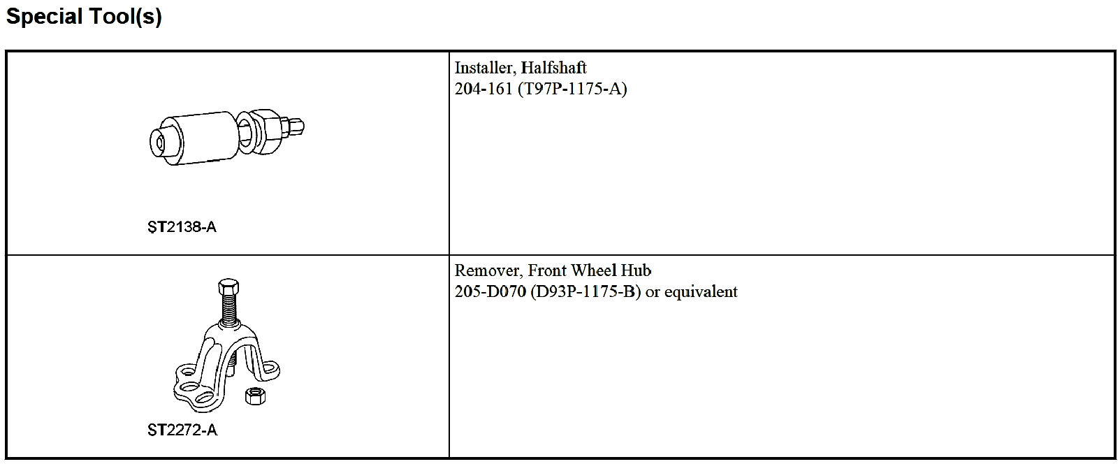

Using the Front Wheel Hub Remover, press out the half shaft from the wheel hub and detach the RH half shaft from the wheel hub.
- Support the half shaft assembly.

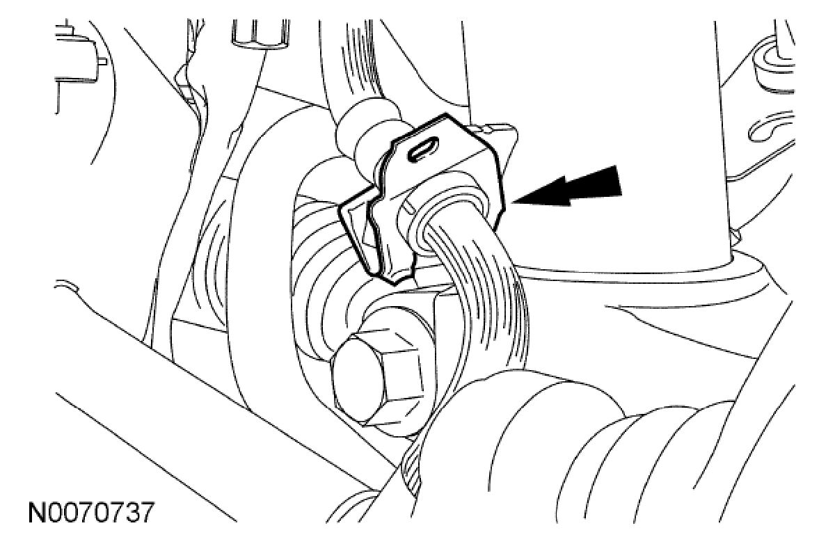

6. Remove the brake hose retainer.

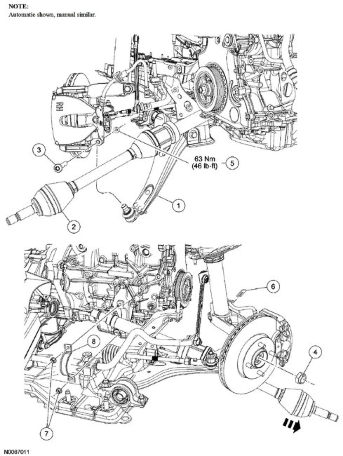

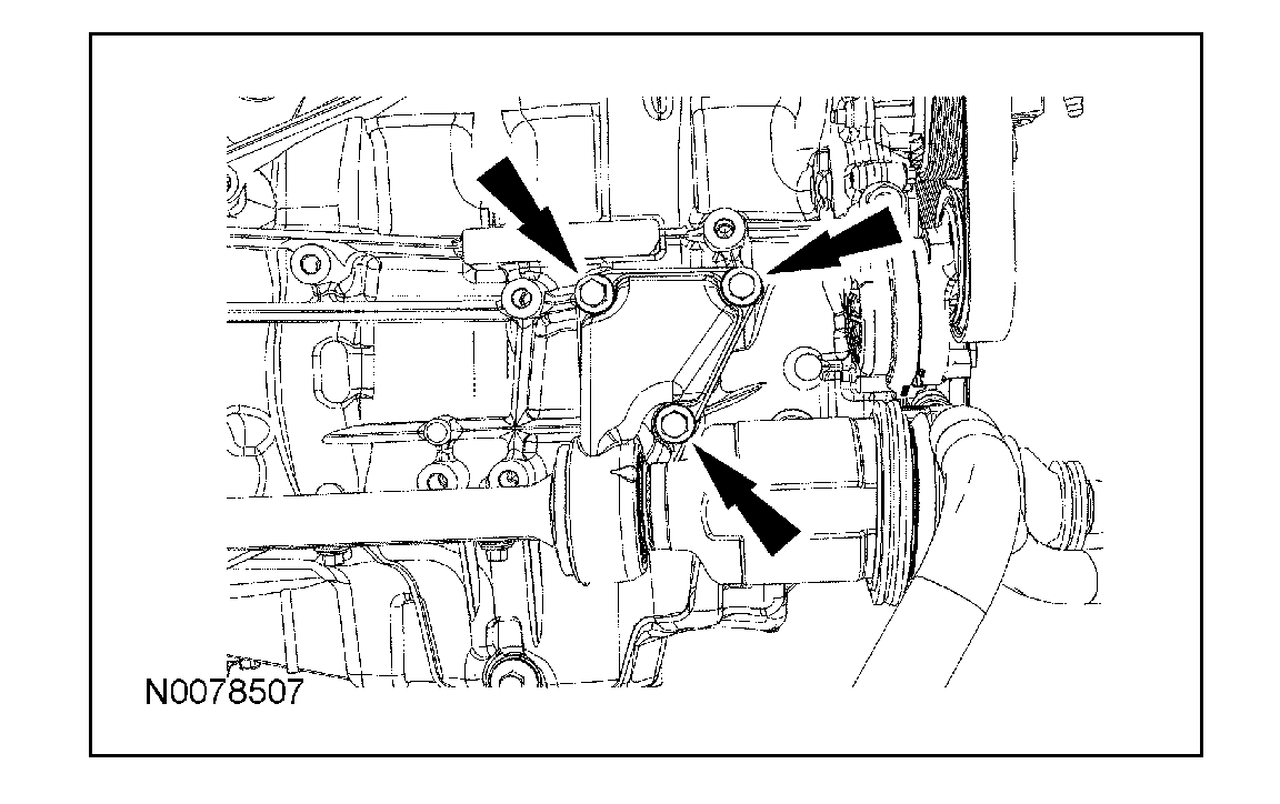

Automatic transmission vehicles
7. Remove and discard the retaining strap and 2 nuts.
pic 7
Manual transmission vehicles
8. Remove and discard the 3 bracket-to-block bolts.
pic 8
All vehicles
9. Remove the RH halfshaft.

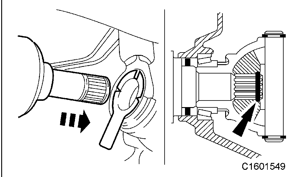

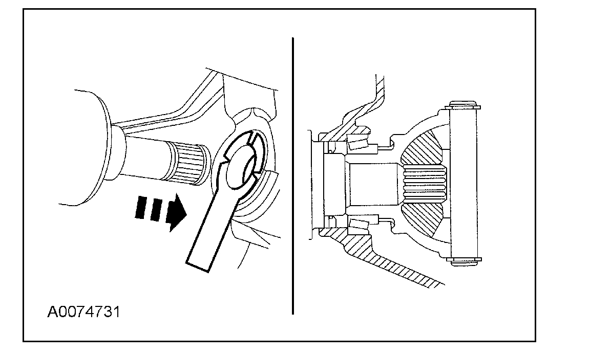

1. Install the RH halfshaft with the intermediate shaft into the transmission.
pic 9
2. NOTE: Install a new retaining strap and 2 nuts on the intermediate shaft bearing.
Install the front halfshaft with intermediate shaft into the transmission.
^ Tighten the lower nut to 5 Nm (44 inch lbs.).
^ Tighten the upper nut to 25 Nm (18 ft. lbs.).
^ Tighten the lower nut to 25 Nm (18 ft. lbs.).

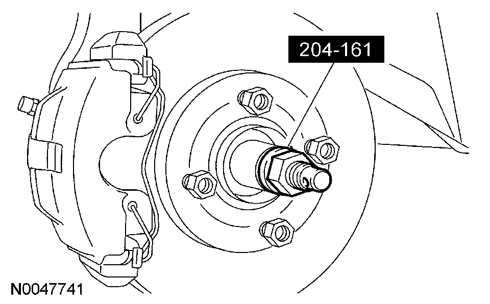

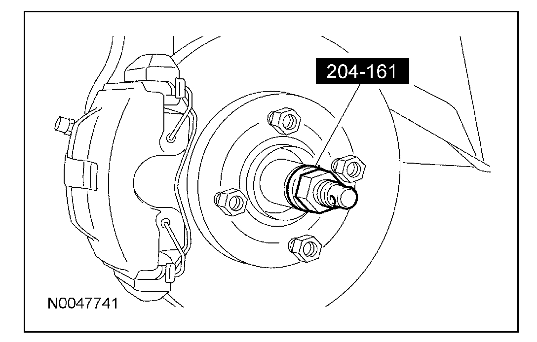

5. Using the special tool, install the RH halfshaft stub into the wheel hub.
pic 11

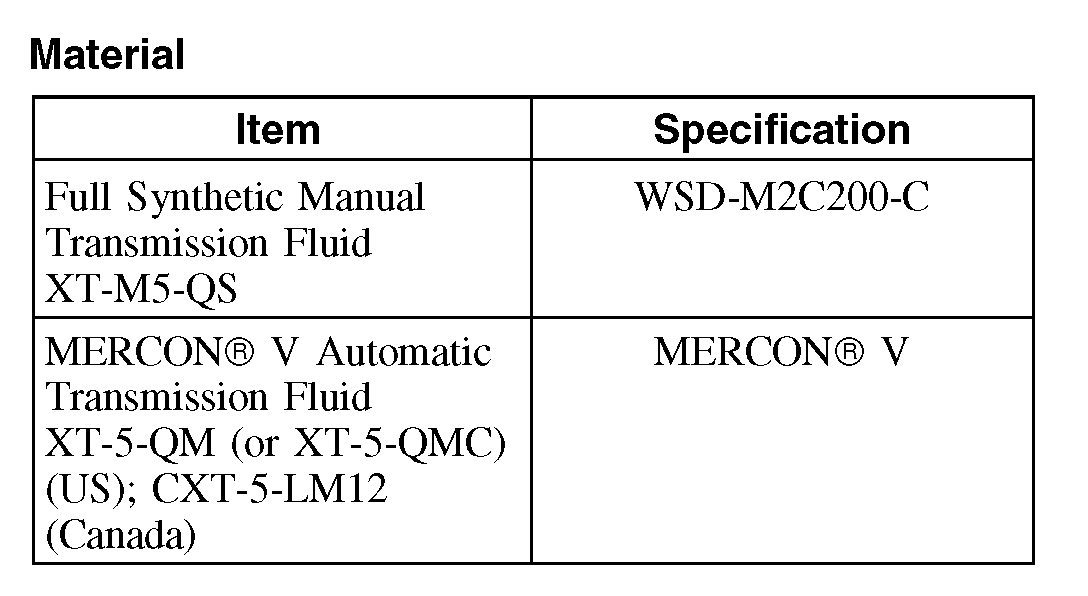

10.Check the transmission fluid level.

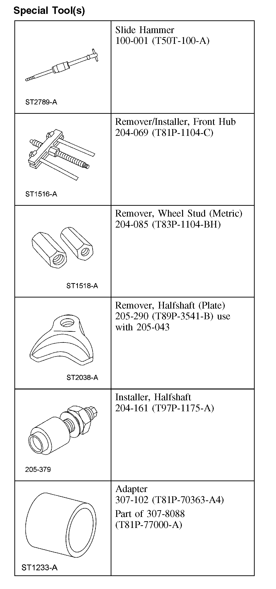

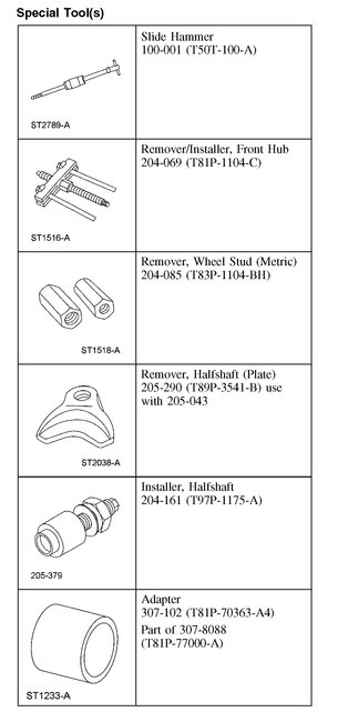

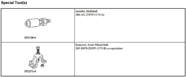

Special Tool(s)
pic 14

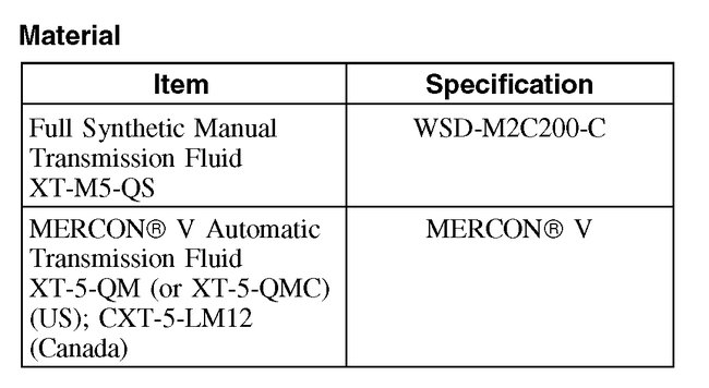

Material
pic 15

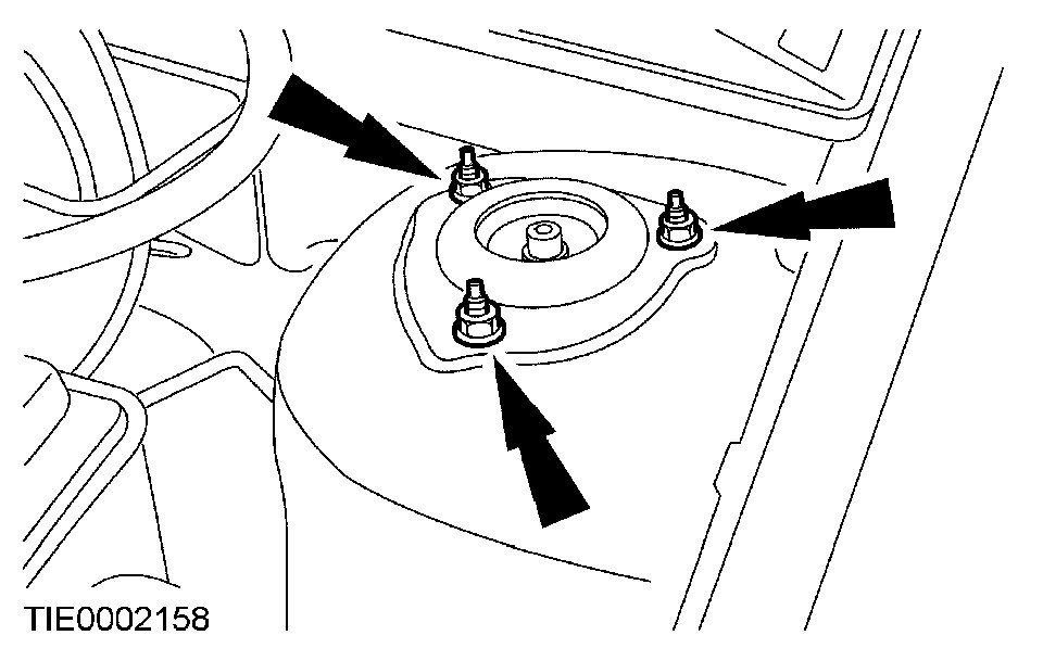

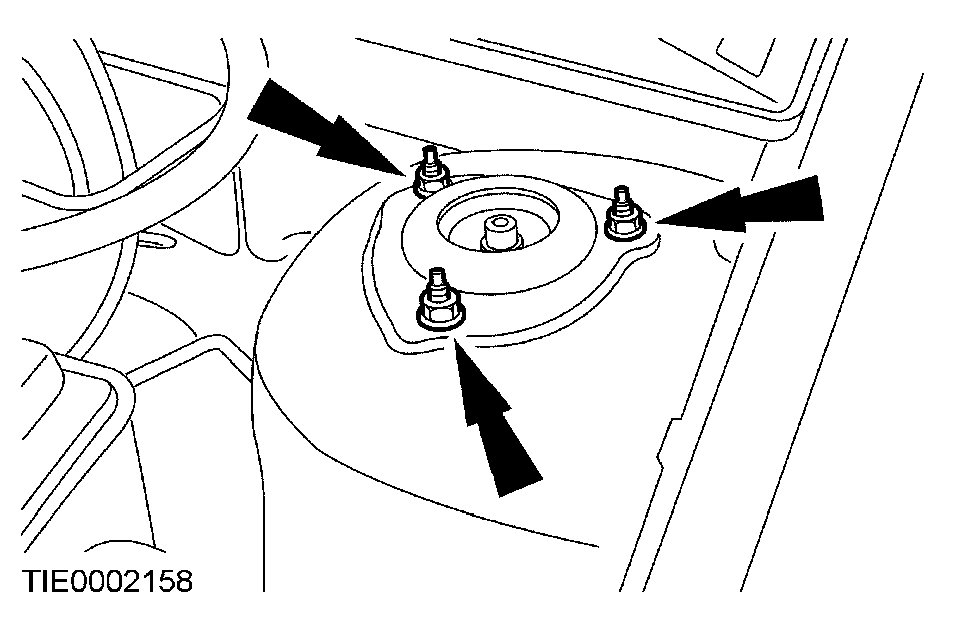

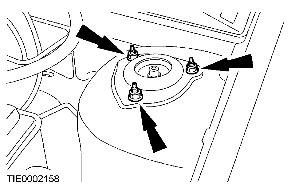

1. Loosen the LH strut and spring assembly top mount nuts by 4 turns.
pic 18

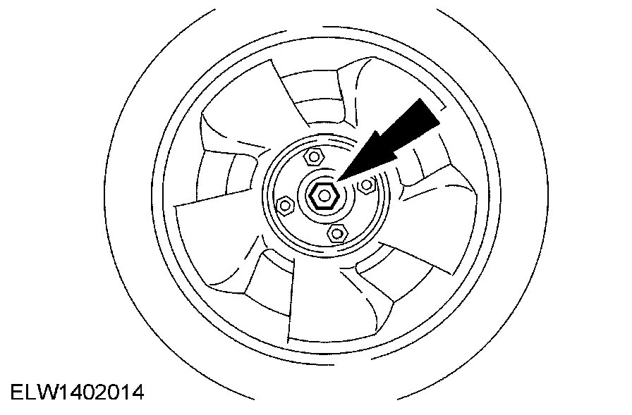

2. CAUTION: Do not use power tools to remove the nut. Use a socket to loosen the wheel hub retaining nut to prevent damage.
^ Loosen the nuts.
^ Loosen the wheel nuts.
^ Loosen the wheel hub retaining nut.
pic 19

5. CAUTION: Do not use a prying device or separator fork between the lower arm ball joint and the knuckle. Damage to the ball joint or ball joint dust boot can result. Only use the pry bar by inserting it into the lower control arm body opening.
Detach the lower arm ball joint.
1. Remove the lower arm ball joint nut and bolt.
2. Detach the ball joint.
^ Insert a pry bar in the lower control arm body opening to separate the ball joint.

7. Detach the LH drive halfshaft from the wheel hub.
^ Using a commercially available puller, unscrew and remove the hub retaining nut and press out the halfshaft stub from the wheel hub.
pic 23

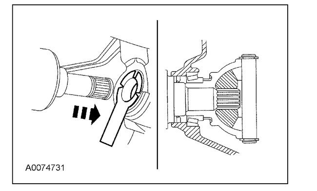

8. CAUTION: Support the halfshaft. The inner joint must not be bent at more than 18 degrees.
NOTE: Check for escaping oil.
Remove the LH drive halfshaft from the transaxle.
^ Close off the transaxle opening with an auxiliary plug.
pic 24

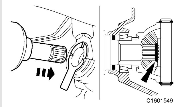

Installation
1. Install new self-locking nuts and a snap ring.
CAUTION: Support the halfshaft. The inner halfshaft joint must not be bent by more than 18 degrees.
CAUTION: Do not damage the oil seal when inserting the front drive halfshaft.
2. NOTE: Make sure the snap ring is fully engaged, by pulling on the joint housing.
NOTE: Remove the auxiliary plug from the transaxle opening.
Install the LH drive halfshaft and snap ring into the transaxle.
pic 25
3. Using the special tool, install the LH halfshaft stub into the wheel hub.

4. Check the transmission fluid level.

8. Tighten the LH strut and spring assembly-to-mount nuts.
^ Tighten to 30 Nm (22 ft. lbs.).
pic 29
