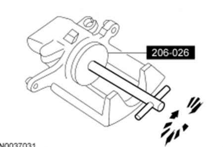

i can`t get the piston in the caliper to retract using the universal tool i bought at auto zone. is there a step i`m missing in this procedure? i have tried opening the bleeder valve also.

Left hand caliper turns clockwise, right caliper turns counterclockwise! Push on tool while turning.
https://images.2carpros.com/forum/automotive_pictures/62217_caliper_1.jpg
