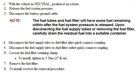

i need to know about changing my fuel filter.

Apr 30, 2010 at 2:31 PM
