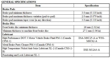

i need to know the front rotor specifications to see if i can just replace the pads or if i need to replace the rotors also

https://images.2carpros.com/forum/automotive_pictures/261618_Noname_791.jpg
