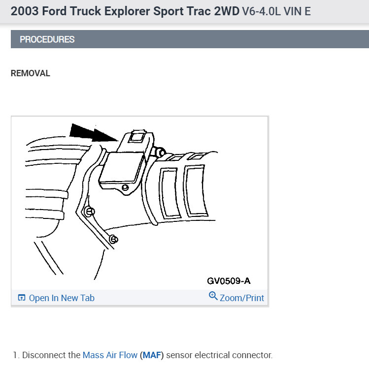

Idle changes between 900 and 2,000 RPMs. Sometimes the engine shuts off but starts right back up. I changed the idle control valve; spark plugs and fuel filter. It will sometimes shut off while driving down the highway but starts right back up.

This can be many things, but I have seen the crankshaft angle sensor cause this problem without triggering any trouble codes, please check out this guide and I have included the location for the crankshaft angle sensor in case you want to swap it out. I have also seen the MAF short out as well causing this problem
https://www.2carpros.com/articles/engine-stalls
and
Check out the images (below). Please let us know how it goes

The maf fixed it. Thank you for your time.
