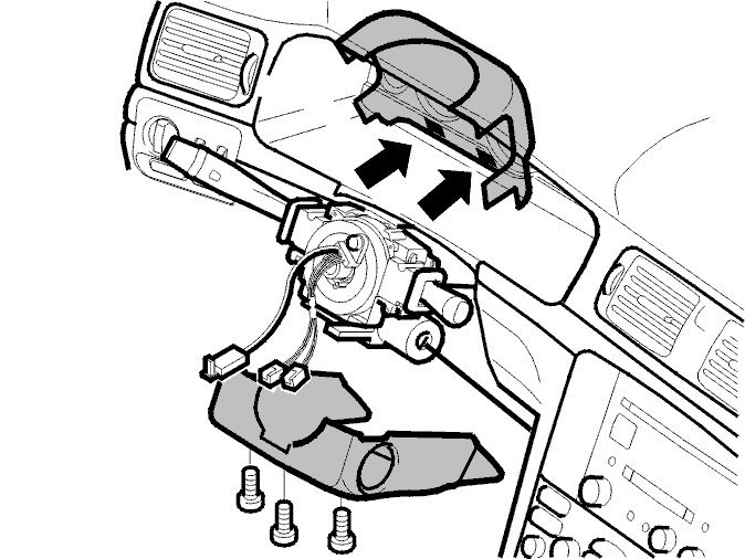

Step1
Remove three screws.
Pull the steering wheel as far out as possible.
Remove the clip mounting between the covers.
Remove the lower steering column cover.
Remove the seal for the clip mounting at the dashboard.
Remove the upper steering column cover.

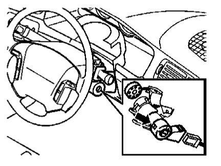

Step2
Remove the connectors
Press in the snap fastener and remove the steering wheel lock unit

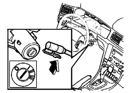

Step3
Remove the mechanical cable for the ignition switch interlock
Move the ignition key to position I
Press up the lock facing and pull out the cable.

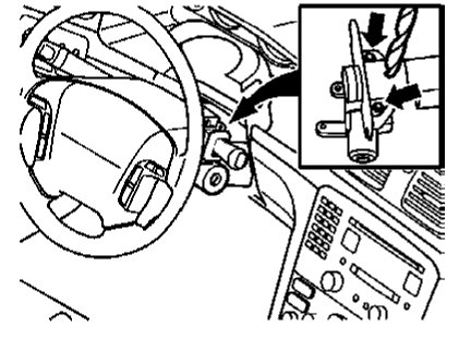

Drill out the security screws holding the steering wheel lock
Remove the steering wheel lock.
