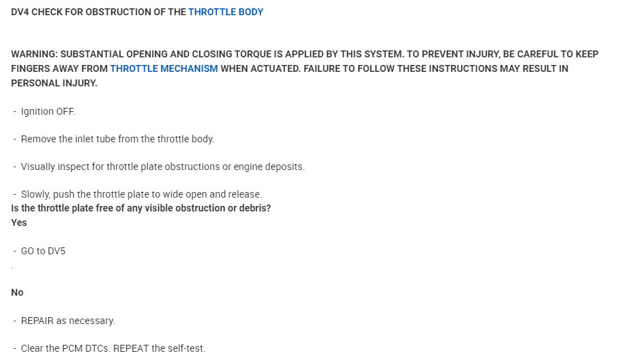

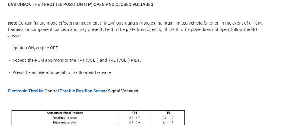

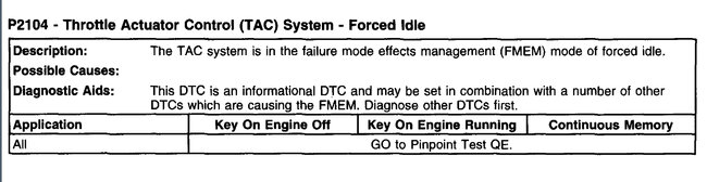

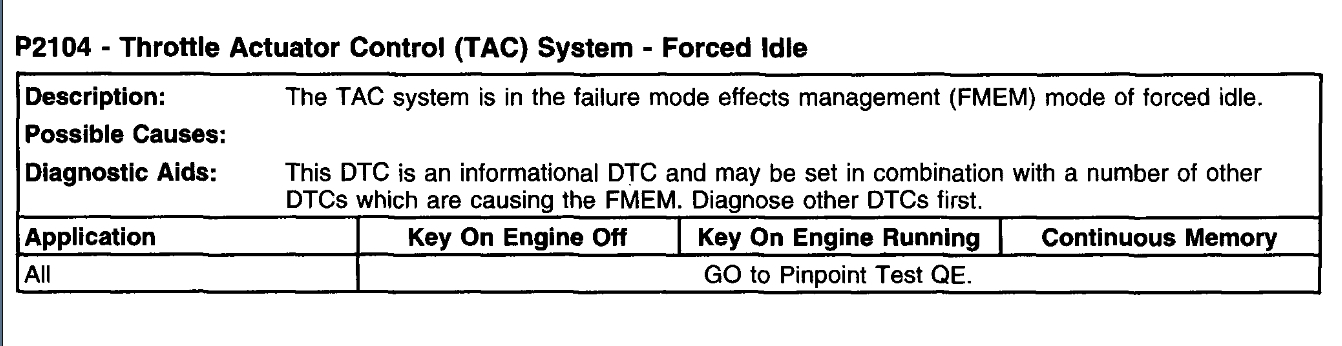

The code you provided is a general code and non-specific. It basically indicates a problem within the throttle actuator control (TAC) system.
If you look at the picture below, it defines the code. Additionally, since it is a general code, it requires the other codes to diagnose/problem-solve the issue.
Since it is an intermittent issue, it could be a connection issue or a damaged wire. However, we need to determine at what point there is an issue.
If possible, let me know what the other code was. If you can't remember it, stop at a parts store and have them scan it for you. Most will do it free of charge.
Let me know what you find.

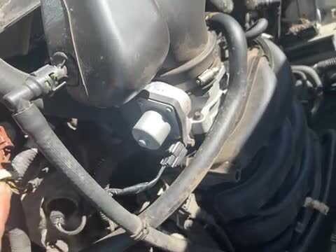

Also, the connector on the side where the motor for the actuator is not the TPS side, that connection was kind of loose, but it has no lock on it to keep it in place.
Sep 24, 2023 at 1:32 AM
  • 110,244 POSTS

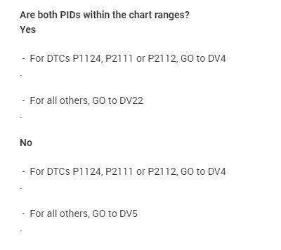

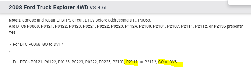

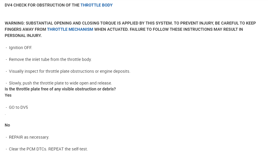

As far as the connector is concerned, is it damaged (no latch)? Are you able to secure it with a zip-tie?
I attached a few things below for you to review and test. Try them and let me know the results.
Sep 24, 2023 at 6:32 AM

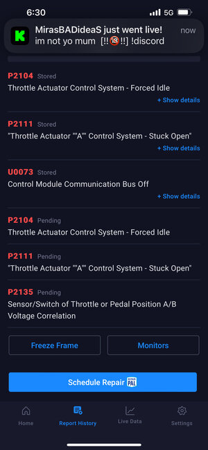

Here is a picture of all the codes I got. Are they all related? Or is it multiple things going on?
Sep 24, 2023 at 11:16 PM
  • 110,244 POSTS
Yes, the all appear to be related. Keep in mind the ones that indicate pending and not active at this point, but are related.
