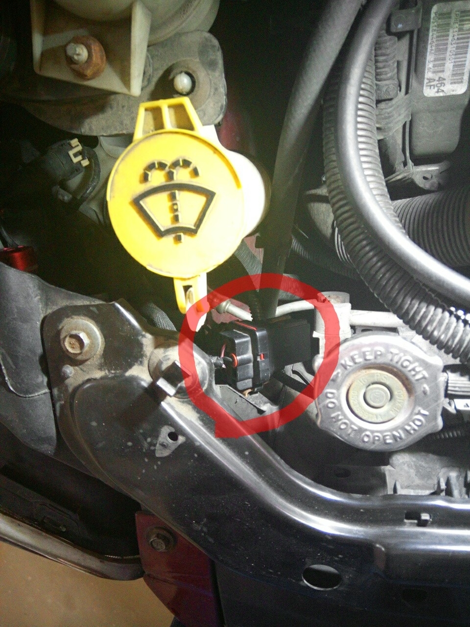

Hello friends,
I'm asking about the relay which is placed between cooler and right lamp. I don't know what is it for? The same relay is between left lamp and the cooler and it is for high speed fan cooler.
Thank you for your reply.
Have a nice day,
Pawel
Jan 7, 2021 at 9:25 PM

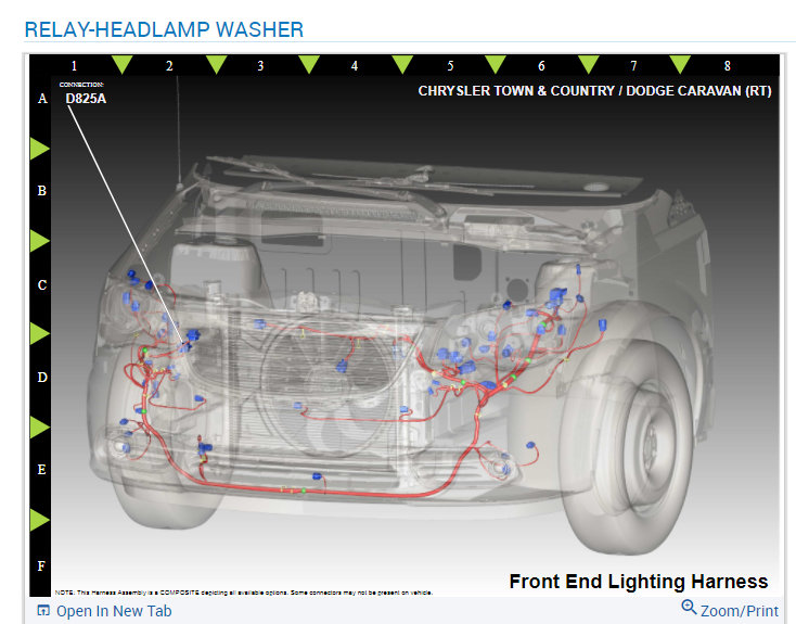

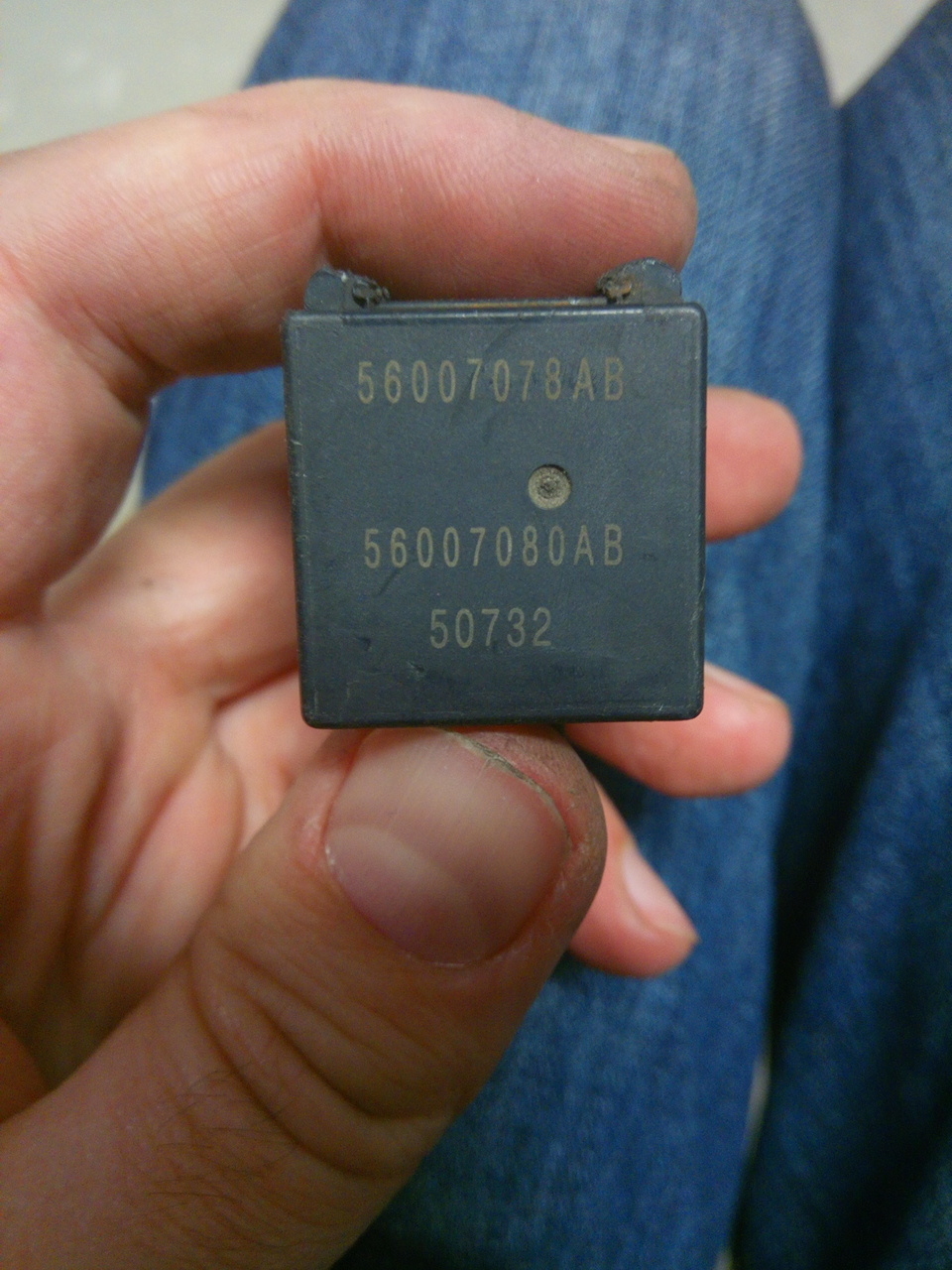

The relay itself is interchangeable with other relays so we need to unhook it and find out what does not work in order to determine which one it is. The reason is, you have a fog lamp relay and headlamp/washer relay in that area so we don't know which one this is just by its location and number. That part number that is on top of it is just for a relay so unhook it and see if either of these does not work and that will tell us what it is.
Let us know what you find. Thanks
I don't have headlamp/washer system so this relay looks like for fog light. I will check it again. Thanks
