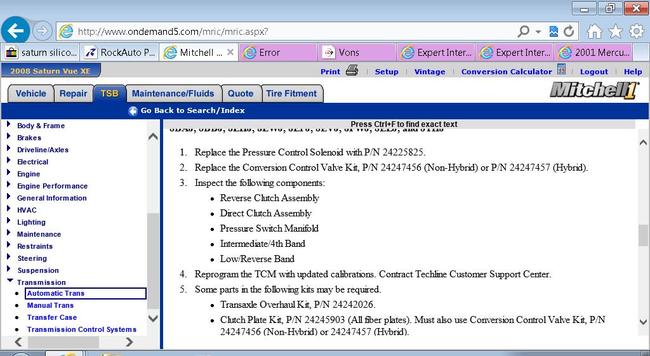

for saturn tech TRANS FAILED SUDDENLY no PRIOR SYMTOMS
70,000 MILES
FIXITMR
  • 9,989 POSTS
HAH i think i read about TRANS ISSUES with these AWD XE? i think it's UNDER 100K . reverse went out and wouldn't shift into all gears. shop said band broke $1000 to fix? sounds CHEAP? ....................................OK what's this CRAP about DETAILS TOO SHORT? question not accepted? i guess this augta do it if i just rattle on some more.......
Nov 15, 2013 at 8:55 AM
SATURNTECH9
  • 30,868 POSTS

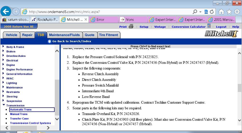

I posted the fix for loss of reverse in a bulletin I found for your vue.Says due to direct coast clutch failure which was redesigned I would check on what the powertrain warranty on that is since the mileage is low.
