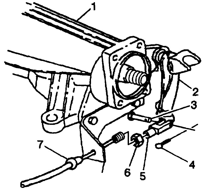

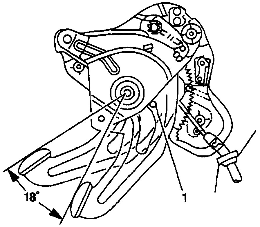

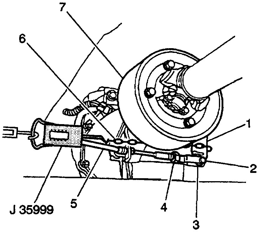

Here is what the manual is showing. Note: The rear wheels will hold the vehicle (parking brake) not the front.
The directions show adjustment starting at the parking brake pedal. Here are the directions. The attached pics correlate with the directions.

1. Remove the clevis pin (3) from the lever (2).

2. Set the parking brake by pushing the pedal down 18 degrees.
^ Insert a 3 mm (.125 inch) pin into locating hole (1) in the pedal assembly.
^ Push the pedal down until the pin contacts the parking brake outer flange.

3. Install J 3599 with a small length of cable or chain, and a tightening device (like a turn buckle) on the frame.
4. Install a small chain (6) on the lever (1) near the spring on the bottom of the lever.
^ Tighten the tightening device until J 3599 is at 222 Nm (50 ft. lbs.).
5. Loosen the nut (4) and turn the clevis (3) until the pin (2) slides freely in the lever (1) with all slack removed from the cable.
6. Install the clevis pin (2) and the cotter pin.
^ Tighten the nut (4) to 37 Nm (27 ft. lbs.).

7. Remove J 35999 and all extensions used.

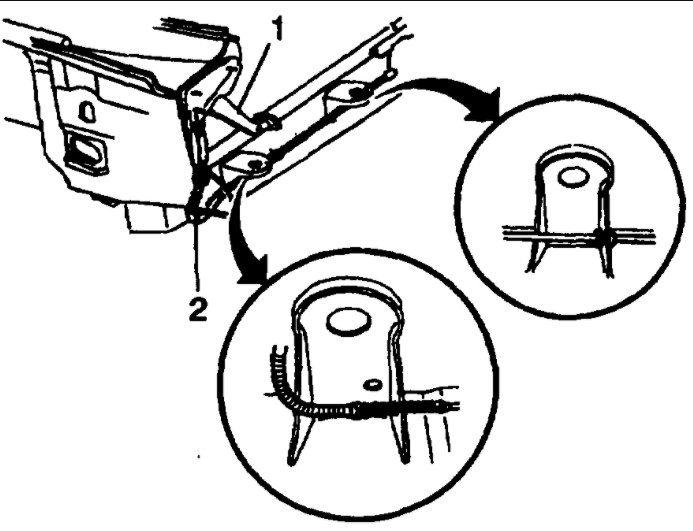

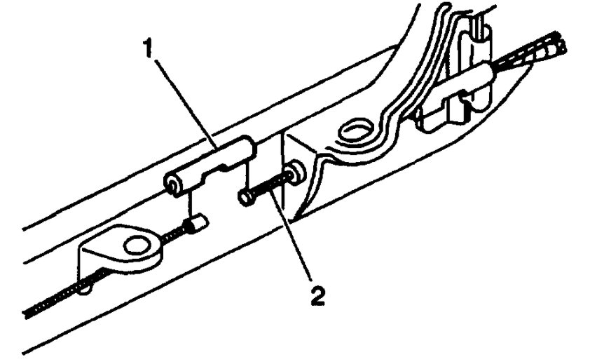

Just here to add my 2 cents. You also might to look near the footwell where the cable exits the body from the foot pedal to the outside of truck along frame rail. There is a metal cable that has a disconnect the keeps the separate cables attached until it hooks to the rear brake assembly. Just visually inspect to see if something became broken or disconnected along the way. That usually causes a parking brake with no feeling of pedal at all like you described. I've attached a few pictures below of what the parking brake cable looks like that runs underneath your truck along the frame. Hope this helps and keep us updated. Thanks again for using 2CarPros.
