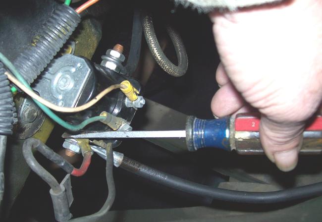

ABOUT 5 OR 6 RESPONSES UP IS THE ONLY PIC I HAVE HAD SHOW UP FOR YOU IN A WHILE!
IS THIS WHAT YOUR SOLENOID LOOKS LIKE?
AS YOU CAN SEE I HAVE THE POSITIVE BATTERY CABLE AND ALL ACCESSORIES STACKED UP ON THE LEFT BIG LUG (BOTTOM IN PIC)
THE SCREWDRIVER TIP IS PUSHED AGAINST THIS
SWAYING THE SCREWDRIVER SHAFT OVER AND TOUCHING "S" ....AT THE SAME TIME......ENERGIZES "S" AND THE STARTER SHOULD TURN OVER (THIS IS EXACTLY THE SAME AS USING A JUMPER OFF OF THE POS BATTERY)
EVEN IF THE STARTER CABLE WAS NOT ON THE SOLENOID AT ALL----YOU WOULD STILL GET A HEAVY-HEAVY CLICK WHEN THE SOLENOID ENERGISES
I'M NOT GONNA POINT AT THE SOLENOID AS BEING BAD ........YET (LOOKING THAT WAY, SO FAR)
LETS INSURE THIS IS NOT A PROBLEM 1ST

SEE-UNS HOW PICS JUST AIN'T WORKIN' YET........I'LL TRY ONE MORE TIME
IN THE ABOVE LINK--I COPIED IT ONTO A NEW TAB---THEN I SAVED IT IN MY IMAGES---THEN I "LIGHTENED" IT UP USING MY PICTURE MANAGER, SO I COULD READ THE PLASTIC RAISED LETTERS ABOVE THE LITTLE TERMINALS
THE LITTLE TERMINAL ON THE LEFT SIDE IS "S"........THE LITTLE ONE ON THE RIGHT IS "I" (AS I HAVE SORTA PREACHED ALL ALONG----THIS IS THE CORRECT SOLENOID IN MY LINK!
WANNA TEST IT FOR A HEAVY CLICK BEFORE YOU INSTALL IT???
HOOK UP YOUR JUMPER CABLES TO YOUR BATTERY
HOOK THE NEG CABLE TO THE MOUNTING BRACKET OF THE NEW SOLENOID
"TOUCH" THE POSITIVE JUMPER CABLE TO THE "S" TERMINAL (LITTLE ONE ON THE LEFT) FOR ABOUT A SECOND----THIS IS ONLY GONNA BE A TEST TO HEAR THE CLICK---YOU SHOULD INSTANTLY HEAR IT
EVEN THOUGH IT AIN'T ALL HOOKED UP---YOU JUST VERIFIED THAT THE ELECTRO-MAGNET INSIDE IT DOES WORK!...........INSTALL IT!

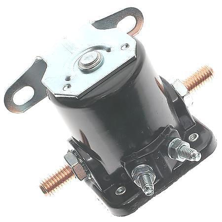

I have made some success with this dad-gum Jeep.
The solenoid that I bought to replace the original solenoid are not the same type.
The solenoid I have has the 2 side posts, the 2 front posts, and also a nipple on the back.
I finally figured out that the nipple is for the ground!
That being said, I attached the battery cable/accessory cable to post A
I attached the starter cable to post B
Ignition is attached to C(S) and the ground is attached to the nipple on the back.
When the key is turned the solenoid clicks continuously until the ignition is turned off.
The starter does not turn.
2-3 volts are detected on post B, the starter post, when the solenoid is clicking.
So, I know that the solenoid functions but still no voltage to the starter post and the solenoid clicks continuously.
I am excited to get this far and wonder what to do next?
I will try to attach pics of solenoid.
Thanks in advance. Your expertise is valued.

That rapid clicking or buzzing is due to low voltage to the coil in the solenoid, and that can have two different causes. One is a poor connection on one of the battery cables. Not enough current can get through so the voltage drops too much across the bad connection. That's like not getting enough pressure at the nozzle of a garden hose because you're standing on it and creating a restriction. The second thing is is the starter is drawing too much current and it's drawing the voltage down. What I would do next is remove the heavy starter cable, then just get the solenoid operating properly first. We can move on once we know that's working.
Do you have a Chrysler transmission? If you do, they have the neutral safety switch in the ground side of the solenoid's coil. There should be a wire someplace to connect to that ground terminal instead of using a ground jumper wire. We can address that later if necessary.
Apr 26, 2013 at 10:50 AM

The solenoid purchased was the one you suggested in your response from April 23.
There is no exact match for a 77 Jeep DJ5 so I purchased the one you suggested that fits the Gremlin.
I will detach the starter cable and try the solenoid again.
As to the stupid question, there's your answer.
Just following your advice?
Thanks again.
Apr 26, 2013 at 10:26 PM
77JEEPDJ5
  • 13 POSTS
Thanks Cardiodoc.
I detached the starter cable and the solenoid clicks once when ignition activated.
Here are some tests I performed.
1. With Batt/Acc on post A and Ign on post C 9volts transmitted to the starter post B.
As above (1.) with starter cable on post B the post receives 17-20volts??? and continuous clicks.
