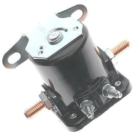

My solenoid hook up is a little different as follows:
A post I have the battery and fusible link to junction block
B post I have the starter cable
C post(S) was vacant when I purchased Jeep; I attached the safety/back up switch purple wire
D post(I) white wire to ignition/key
When I turn the key 12 volts are on the I wire but no voltage to the S wire.
I have replaced the solenoid 2 times and still nothing to the starter?
Could I hook a wire to the S post that is hot when the key is turned?
I don't understand how it was cranking the starter when I purchased with just the I wire hook up and nothing on the S post?

It sounds like you have the wrong solenoid. You have a Ford system and they used at least three different starter systems. All of the solenoids use the same two large copper studs, one to the battery positive cable and one to the starter terminal, for the high-current circuit. The low-current coil inside to operate it has two terminals. One is the small stud on top that goes to the ignition switch and gets 12 volts in the "crank" position. The neutral safety switch is also in that circuit so you have to turn that one on by being in "park" or "neutral". The other end of that coil is welded to the metal mounting plate which means to work, the solenoid has to be bolted to the body. The second smaller terminal is used to bypass the ignition resistor. More on that later.
In a second design, that second wire for the solenoid's coil is not attached to the mounting plate. It is attached to that second small stud instead. The neutral safety switch is connected to that stud. When you're in "park" and that switch is turned on, that stud is grounded. You apply 12 volts from the ignition switch to the first stud when it's in the "crank" position. If that's the solenoid you have, run a jumper wire from the second small stud to ground.

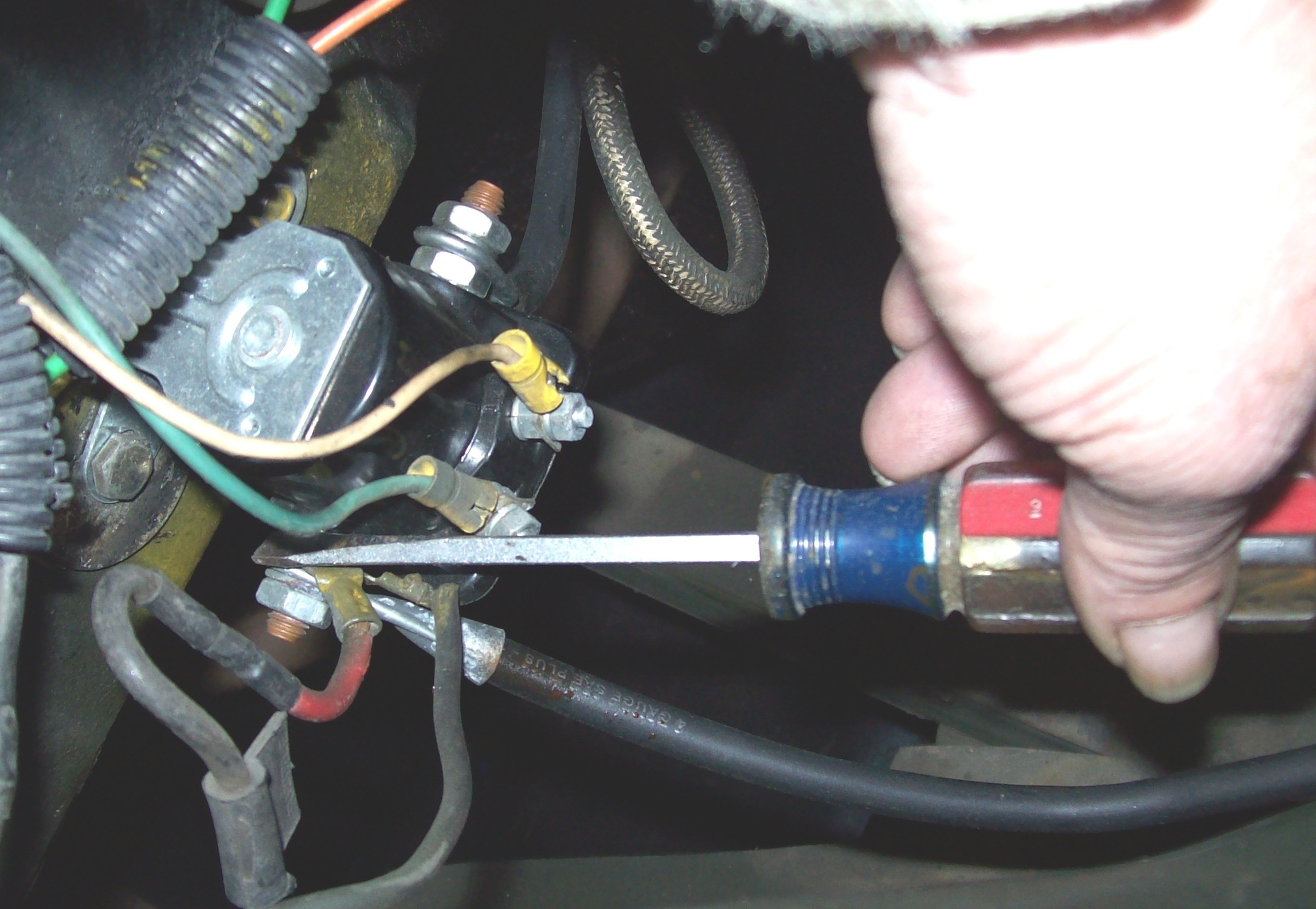

IS THIS WHAT YOUR SOLENOID LOOKS LIKE?
AS YOU CAN SEE I HAVE THE POSITIVE BATTERY CABLE AND ALL ACCESSORIES STACKED UP ON THE LEFT BIG LUG (BOTTOM IN PIC)
THE SCREWDRIVER TIP IS PUSHED AGAINST THIS
SWAYING THE SCREWDRIVER SHAFT OVER AND TOUCHING "S" ....AT THE SAME TIME......ENERGIZES "S" AND THE STARTER SHOULD TURN OVER (THIS IS EXACTLY THE SAME AS USING A JUMPER OFF OF THE POS BATTERY)
EVEN IF THE STARTER CABLE WAS NOT ON THE SOLENOID AT ALL----YOU WOULD STILL GET A HEAVY-HEAVY CLICK WHEN THE SOLENOID ENERGISES

The solenoids in drawings 1 and 4 physically look identical. The letters or numbers molded next to the two smaller terminals might be different. I never paid attention to them. To know which version you need and which one you have I have to use an ohm meter to measure the coil. In Figure 1 there will be continuity, (about 12 ohms, as I recall), between terminal 1 and the metal mounting plate. In Figure 4 the continuity will be between terminal 1 and terminal 2. I think you have that version now and you need the one in Figure 1. If that is correct you can instead connect a jumper wire from terminal 2 to ground.
Also, don't assume you damaged a solenoid just because it isn't working. The only thing you can do to hurt it is to connect a jumper wire to engage it, and leave it engaged for a long time. I did that on a Tempo that I was turning into a trainer for my students. I installed a "bug" that mimicked an open coil, and while testing it, I left it engaged too long while I wrote up the test procedure. The coil overheated after about two minutes and started smoking. Later I determined the coil warped and the movable plunger was sticking on it. Sometimes it would not engage when it was supposed to, especially if the battery was a little run down.

I have made some success with this dad-gum Jeep.
The solenoid that I bought to replace the original solenoid are not the same type.
The solenoid I have has the 2 side posts, the 2 front posts, and also a nipple on the back.
I finally figured out that the nipple is for the ground!
That being said, I attached the battery cable/accessory cable to post A
I attached the starter cable to post B
Ignition is attached to C(S) and the ground is attached to the nipple on the back.
When the key is turned the solenoid clicks continuously until the ignition is turned off.
The starter does not turn.
2-3 volts are detected on post B, the starter post, when the solenoid is clicking.
So, I know that the solenoid functions but still no voltage to the starter post and the solenoid clicks continuously.
I am excited to get this far and wonder what to do next?
I will try to attach pics of solenoid.
Thanks in advance. Your expertise is valued.

That rapid clicking or buzzing is due to low voltage to the coil in the solenoid, and that can have two different causes. One is a poor connection on one of the battery cables. Not enough current can get through so the voltage drops too much across the bad connection. That's like not getting enough pressure at the nozzle of a garden hose because you're standing on it and creating a restriction. The second thing is is the starter is drawing too much current and it's drawing the voltage down. What I would do next is remove the heavy starter cable, then just get the solenoid operating properly first. We can move on once we know that's working.
Do you have a Chrysler transmission? If you do, they have the neutral safety switch in the ground side of the solenoid's coil. There should be a wire someplace to connect to that ground terminal instead of using a ground jumper wire. We can address that later if necessary.
