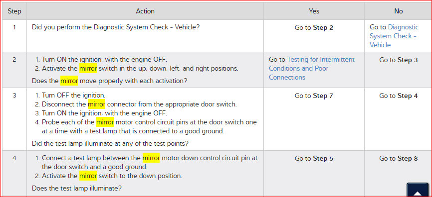

Folding mirror not working
2007 GMC YUKON
115,000 MILES • 6.2L • V8 • 4WD • AUTOMATIC
JWAITE
Driver side will not fold in on its own. When selected and button is pressed the passenger side responds instead. Neither in or out works. Any ideas on the cause?
Sep 16, 2018 at 4:17 AM
DANNY L
  • 5,648 POSTS

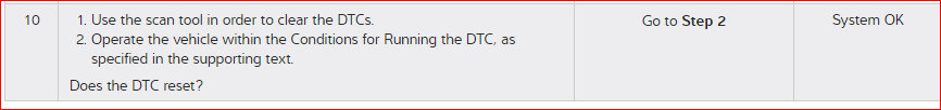

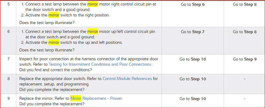

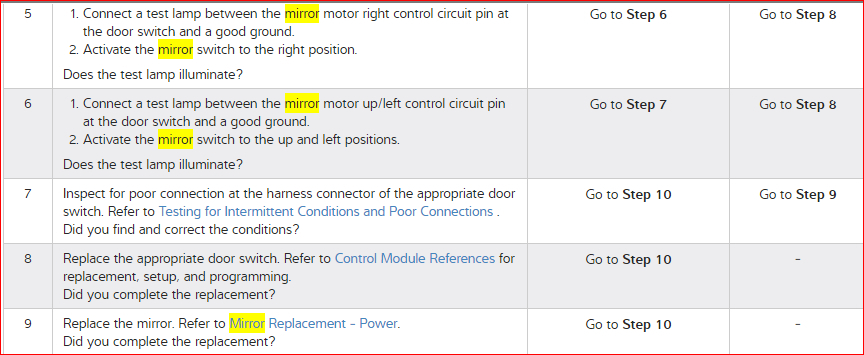

Hello, I am Danny.
I have attached step-by-step directions on how to test and a tutorial as well. Hope this helps and feel free to ask any questions. Thanks for using 2CarPros.
