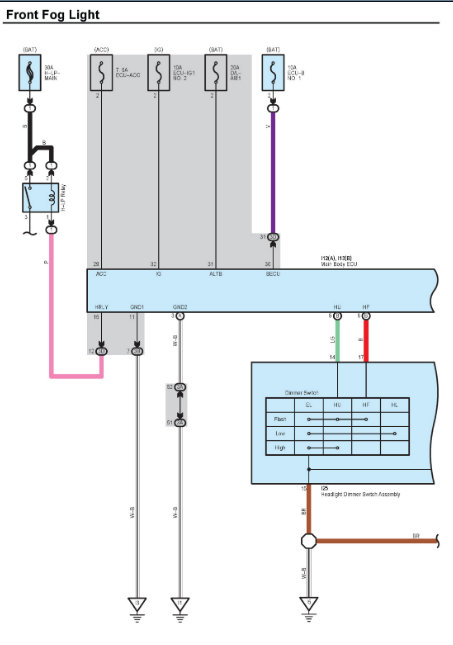

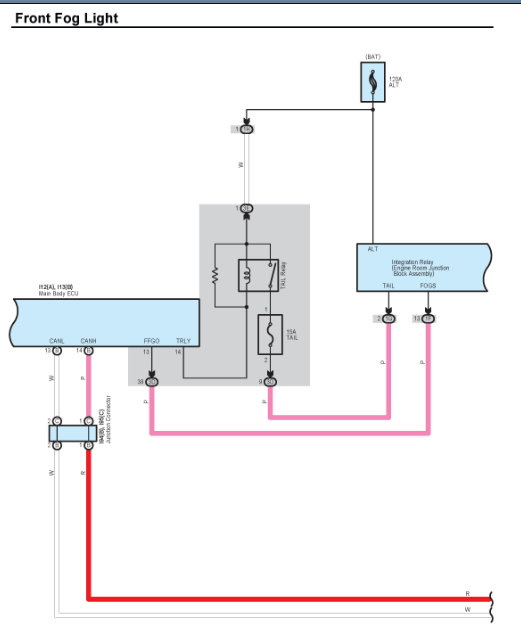

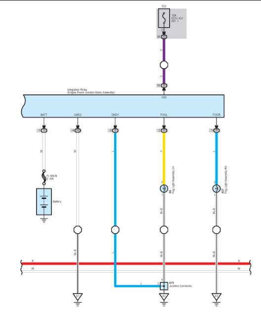

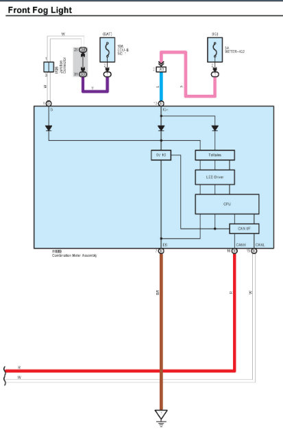

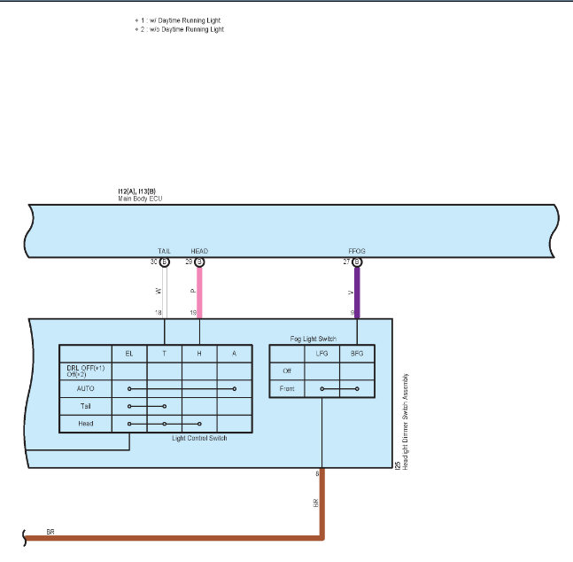

Fog light came with car (factory installed) not working. It only read 130ish mili-volt on on and off mode from the switch . Where can the problem be? How is everything wired?
Jun 4, 2019 at 1:51 PM
DANNY L
  • 5,648 POSTS
Hello, I'm Danny.
Here are the fog light wiring diagrams for your car.This is a tutorial showing how to test wiring.
Pictures are attached below.Hope this helps and thanks for using 2CarPros.

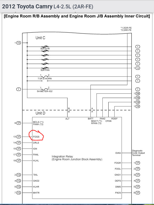

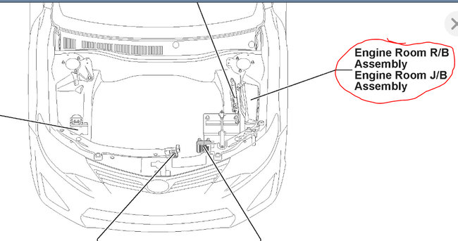

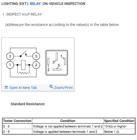

Does the fog light have relay somewhere? If yes, where located? Also what fuse is located and which fuse? Can't find in the fuse box.
Jun 5, 2019 at 10:41 AM
DANNY L
  • 5,648 POSTS
Hello again.
The relay is located under hood in the r/b-j/b box. I've attached the pictures below of its location. Here is a tutorial showing how to test a relay and wiring:
It shows to be in #13 location and circled in red.Hope this helps and thanks again for using 2CarPros.
Danny-
Jun 5, 2019 at 10:46 PM
SAENGS210
  • 10 POSTS
Sorry for late respond. I found the problem. Integration relay went bad. And found one in junkyard. Thanks
