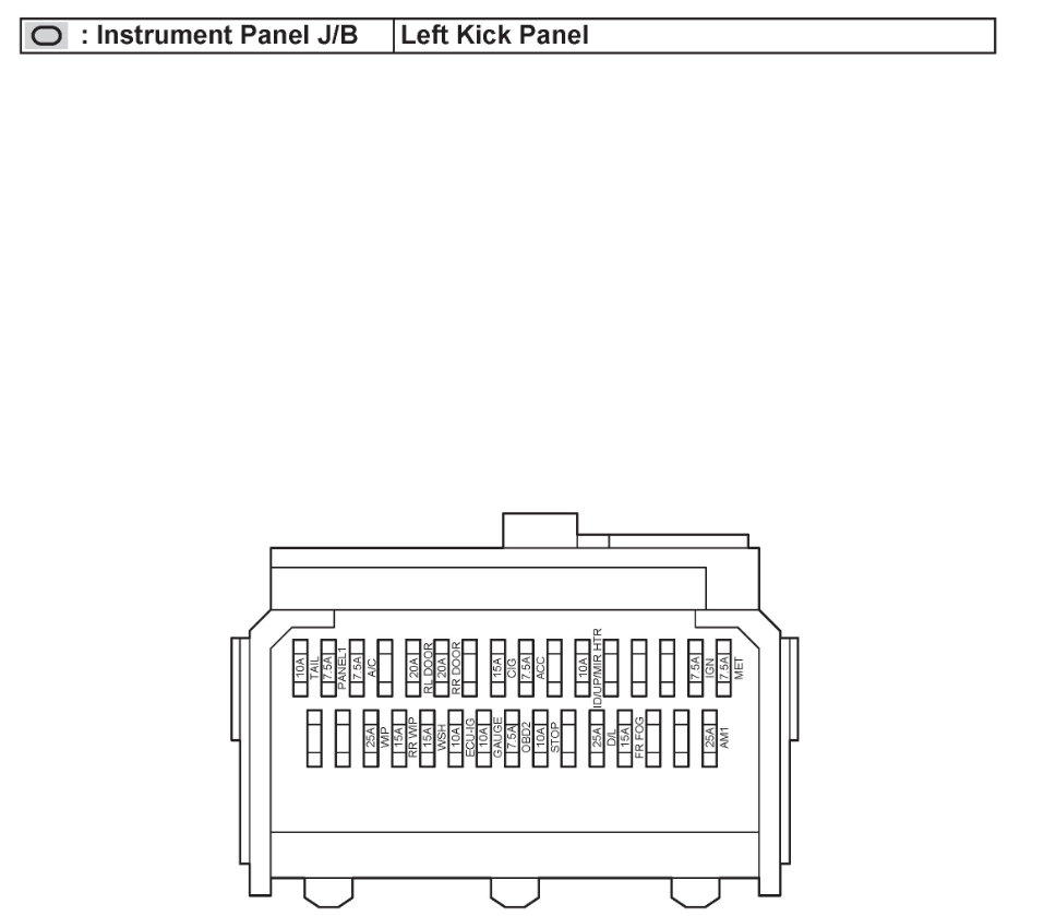

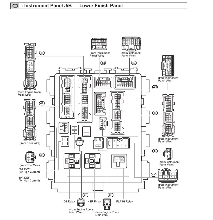

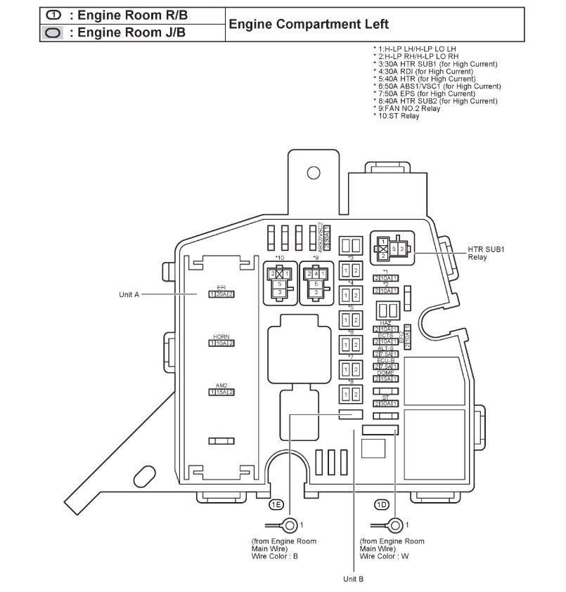

Fog lights not switching on and taillights not working including lower dash where there is AC and heater switches.
Nov 25, 2019 at 2:54 AM
Experienced Mechanic
55,694 POSTS
The first thing we must do is check the fuses. here is a guide with the fuse locations as well. test with the key on.
