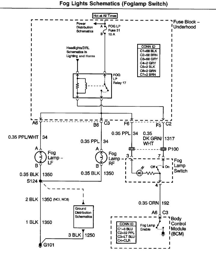

Needing to know the fog light switch wiring diagram.

Attached is the OEM diagram. They are set up so that when the high beams are on the fog lights are switched off by the BCM.
