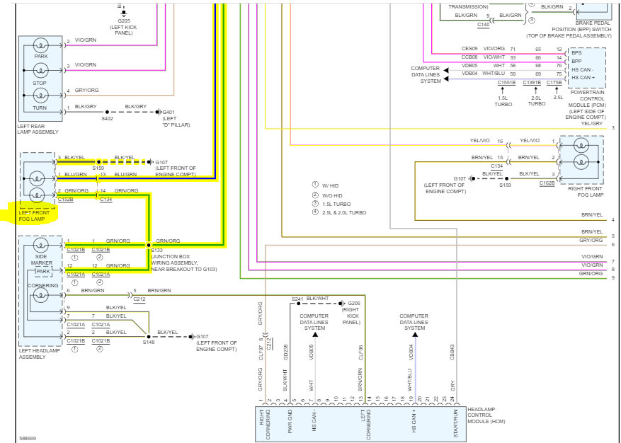

A couple of weeks ago I ran over a piece of shredded tire in the road. It flipped up and busted out my driver side fog light (no other damage). I replaced the fog light and the 2 bulbs myself, and even after trying a second set of bulbs the left turn signal still blinks fast. I’m trying to figure out what’s wrong with the car, and if it’s possible to fix it myself.

It sounds like you have the same kind of luck as I do. LOL

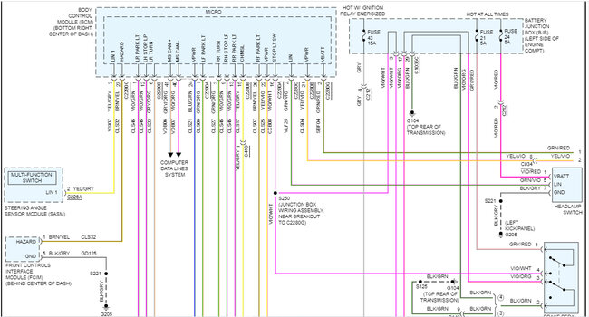

Regardless, I attached the wiring schematic below for the fog lights. I highlighted the left side for you along with the wiring.,
Take a look through them and let me know if they help or if you have questions.
