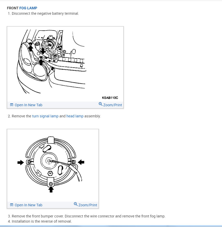

i would like to know how you replace the fog light assembly.
Jul 13, 2020 at 8:07 AM
I attached the procedure for your review. Let me know if you have questions but it looks pretty straight forward. Check out the diagrams (Below). Please let us know if you need anything else to get the problem fixed. Thanks
