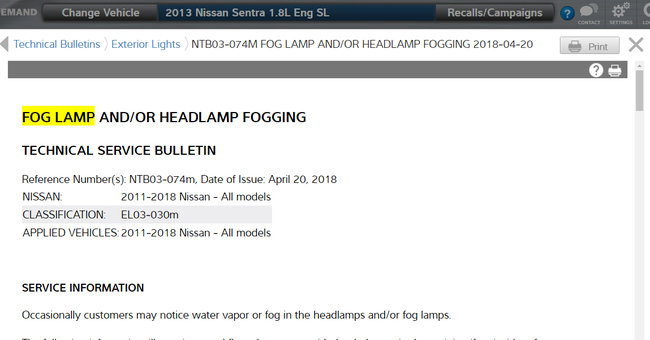

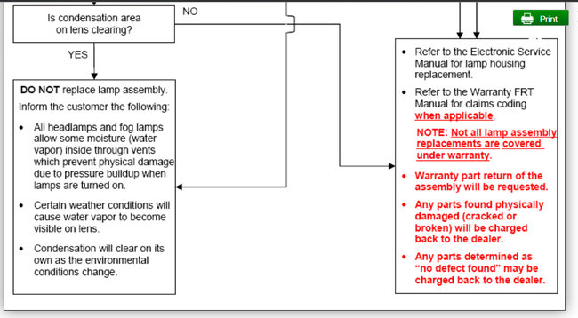

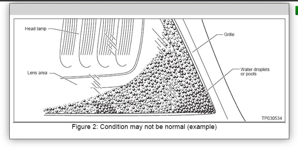

Hello, I got water inside of my fog light housing and I was looking to see if they were a procedure on removing the fog lamp.
May 11, 2019 at 3:45 AM
SCGRANTURISMO
  • 4,897 POSTS

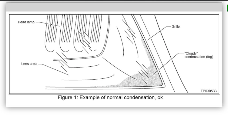

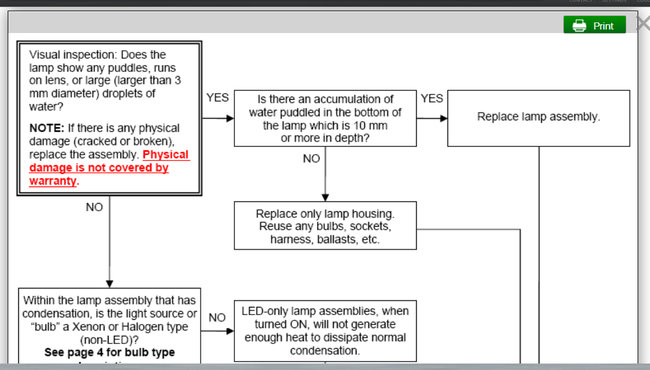

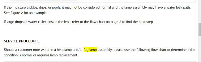

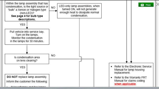

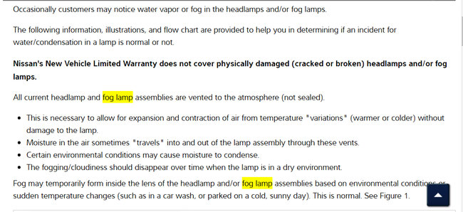

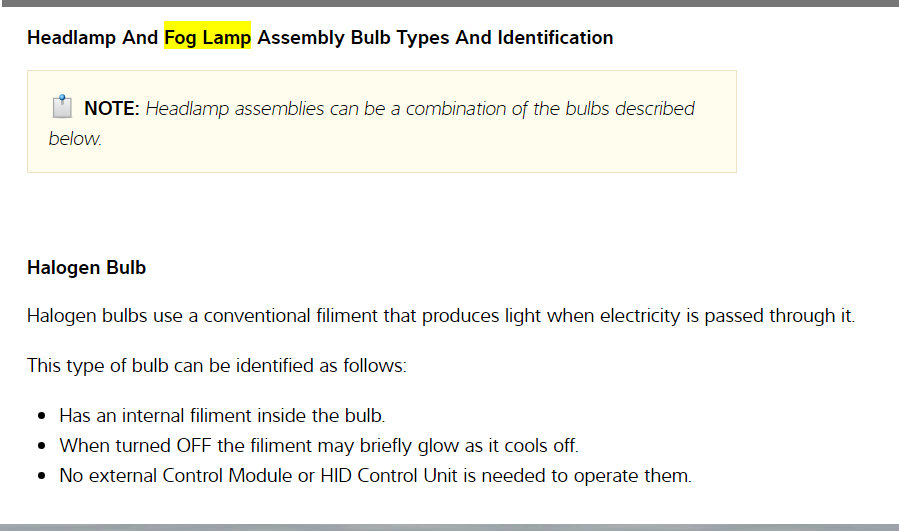

While I was doing research finding the procedure for the removal and installation of your vehicle's fog lights, I came across this Technical Service Bulletin (TSB) from Nissan concerning water or condensation in the fog lights of your vehicle. Please go through this TSB and give your local Nissan dealership a call. You might be able to get them replaced free of charge. Get back to us with what you are able to find out, and if you still need to do the job yourself, we will provide you with the instructions then, and as always, they will be provided free of charge.
Thanks.
