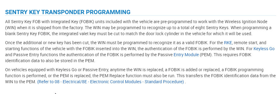

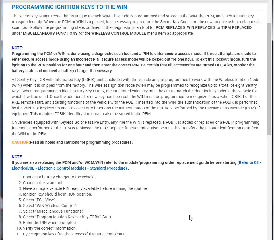

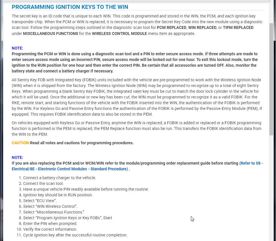

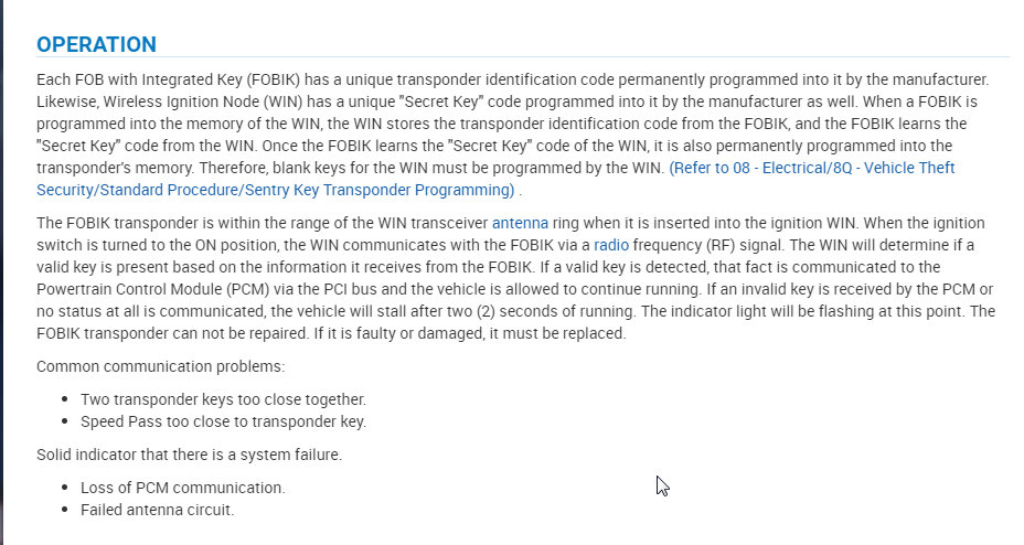

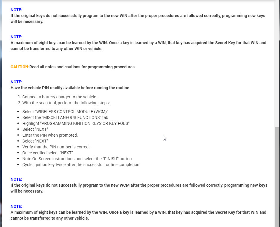

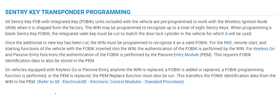

More then likely it is not the key. You have what is called a passive entry module (PEM) and the Wireless ignition node (WIN) that have to recognize the key.
At this point I think we need to scan for codes because I suspect you will have a U1197 code which means the security system has shut down those operations.
If this is the case, you are going to need a scan tool capable of performing the attached relearning and programming features.
Read through this material and let me know what questions you have.
