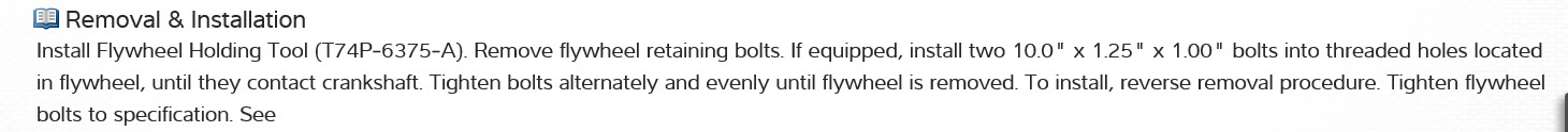

Flywheel removal to resurface.
Sep 9, 2016 at 7:03 PM
HMAC300
  • 48,601 POSTS

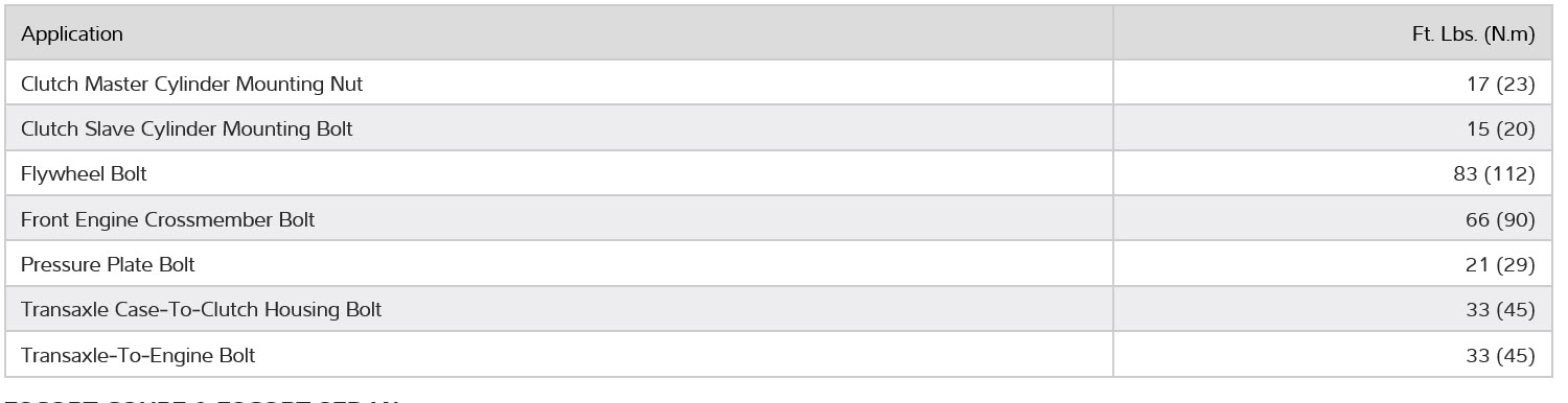

trans has to be pulled then see pic for bolts to get toremove flywheel and for torque specs.
