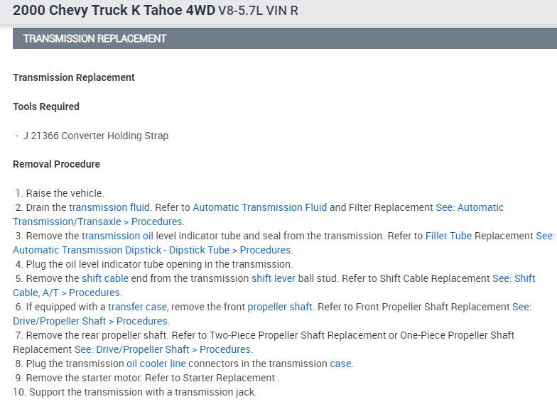

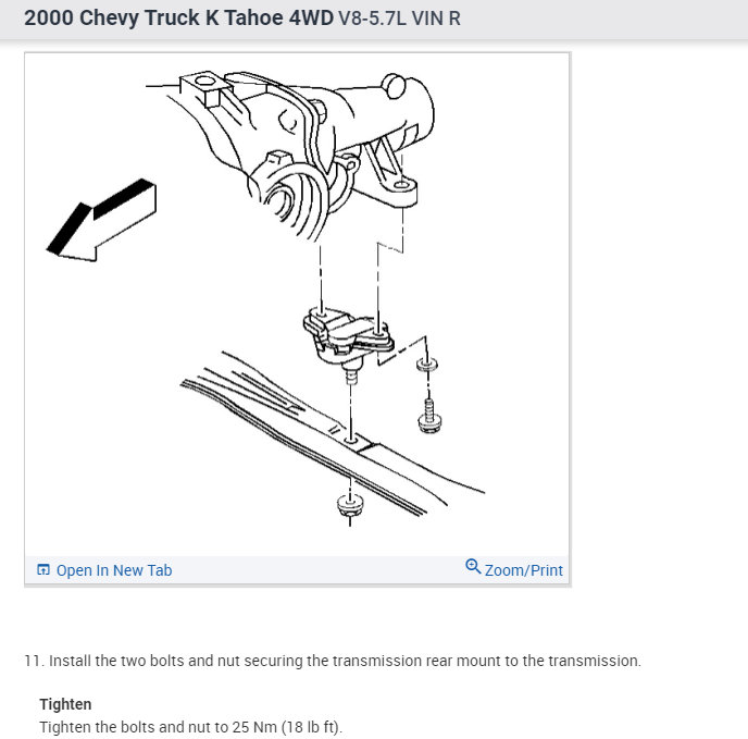

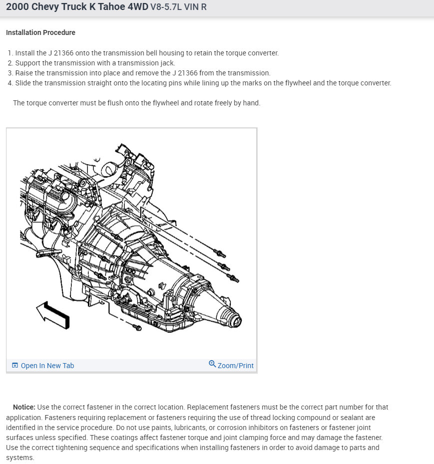

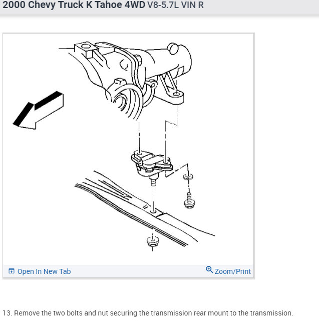

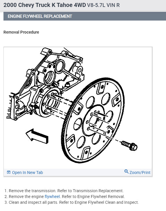

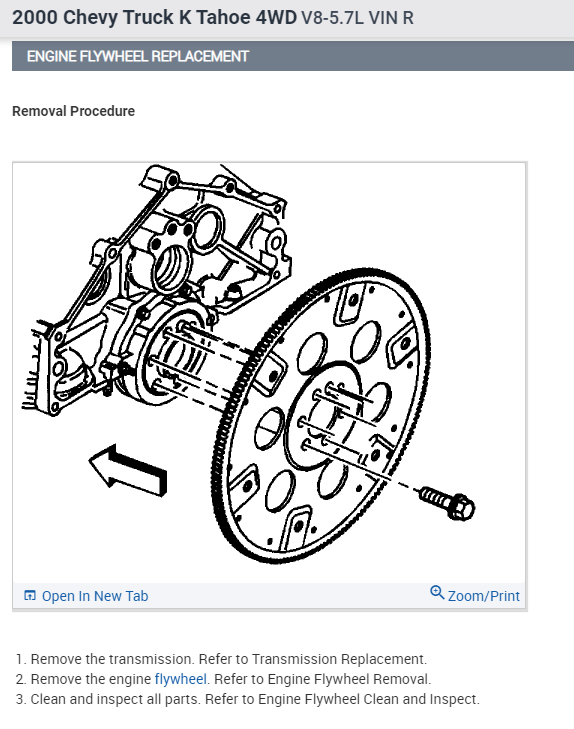

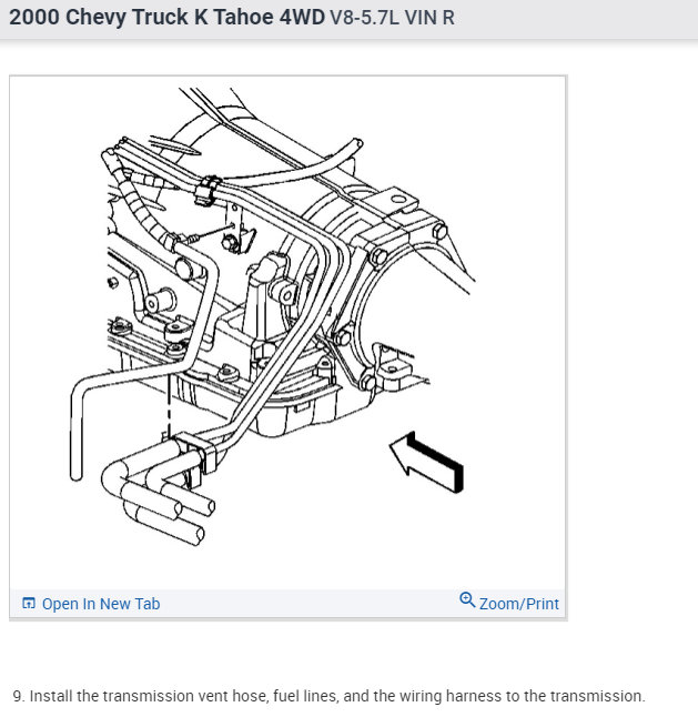

Changing the flywheel, can it be removed without dropping the transmission completely?
2000 CHEVROLET TAHOE
240,000 MILES • 5.7L • V8 • 4WD • AUTOMATIC
JENNIFER_DEAN
Replacing the flywheel.
Jun 21, 2022 at 3:13 AM
SQM
  • 6,383 POSTS

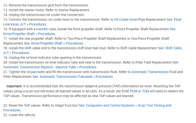

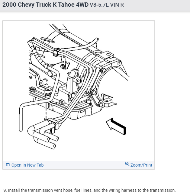

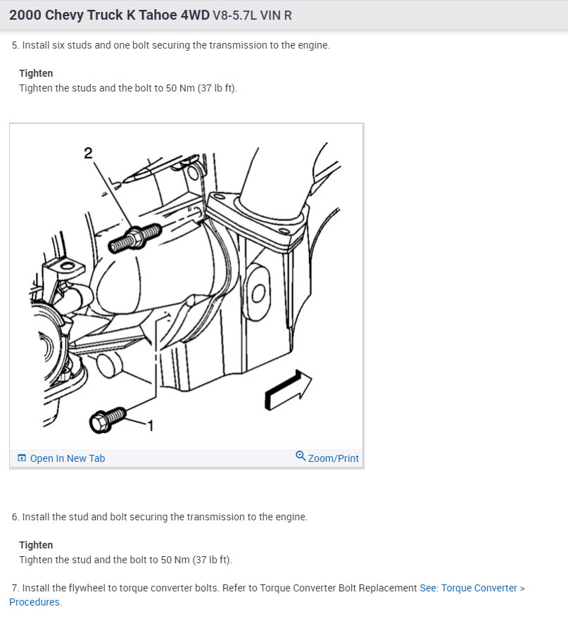

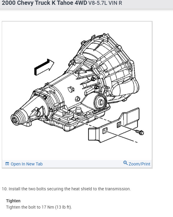

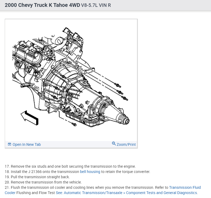

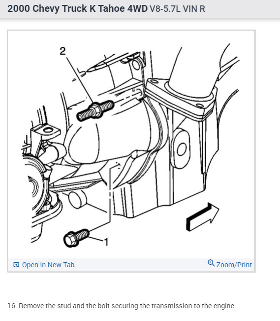

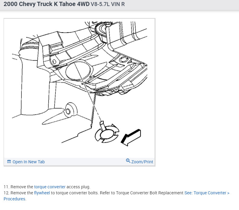

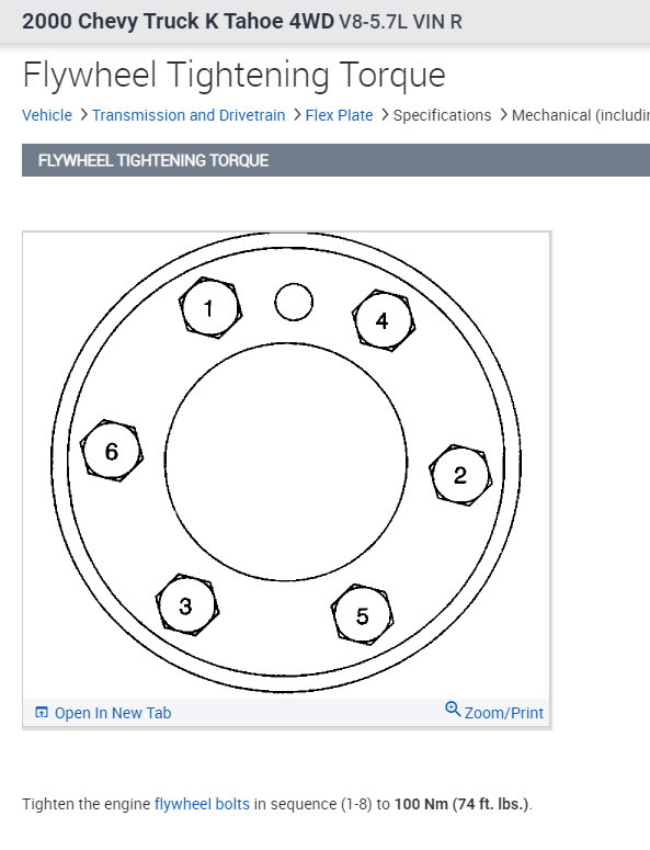

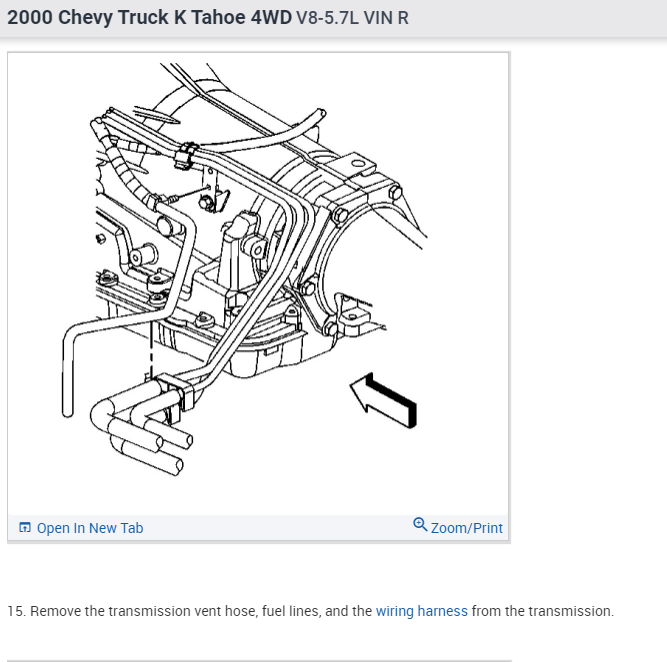

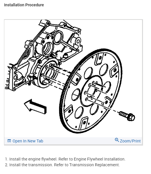

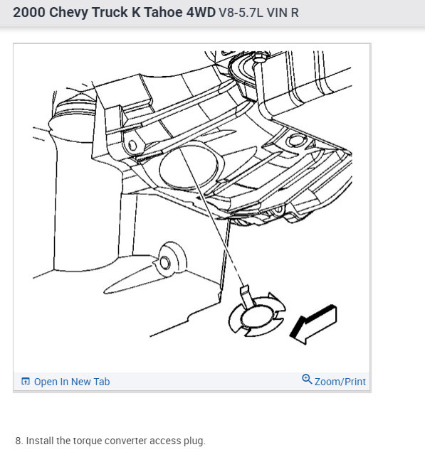

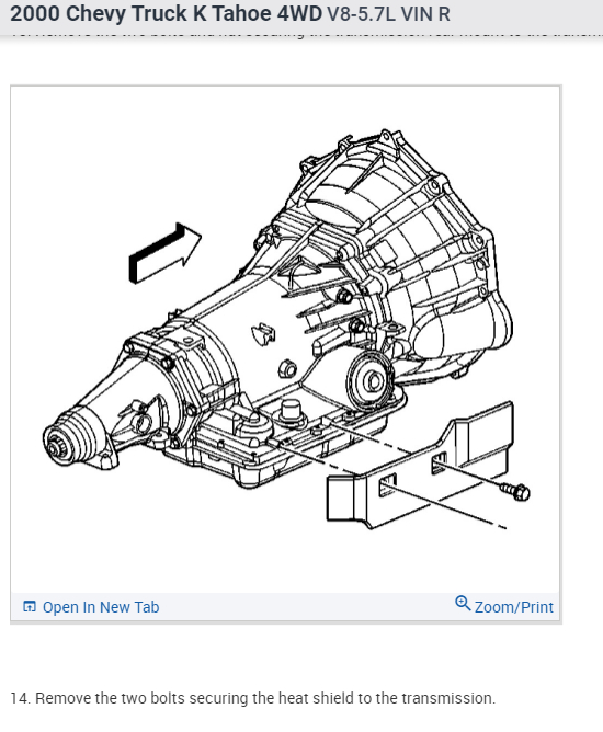

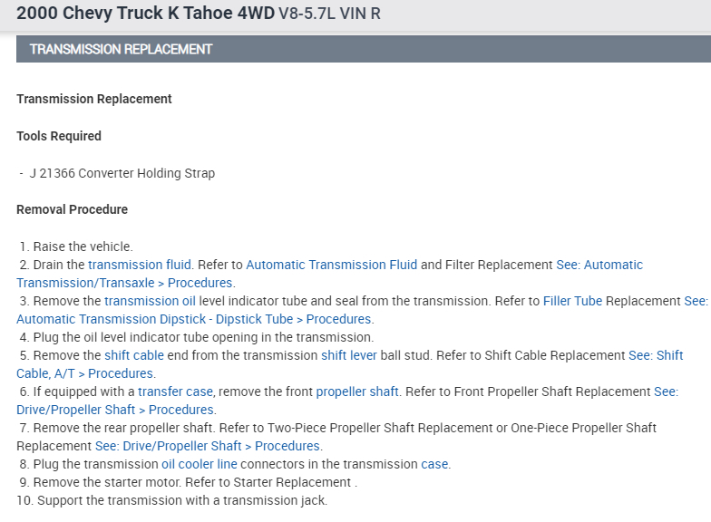

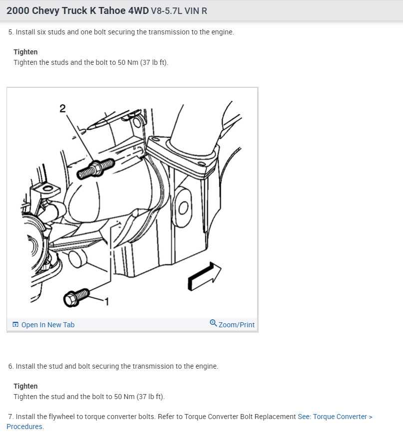

Without removing the transmission, you won't have any way to remove all the bolts from the flywheel.
So, removal of the transmission is necessary.
I have attached the procedure below for your reference.
Let me know of any questions.
https://www.2carpros.com/articles/how-flexplates-work
