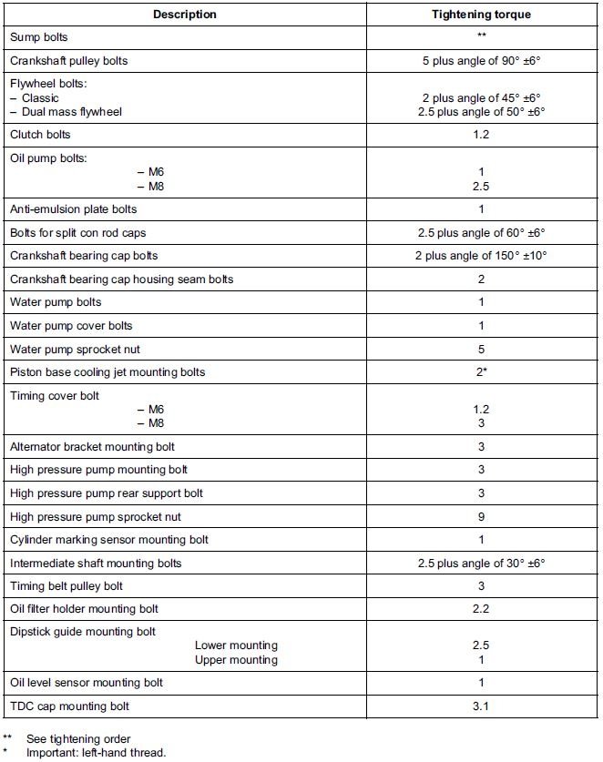

Flywheel bolts torque settings
230,000 MILES • 2.5L • 4 CYL • 2WD • MANUAL
ACHAND
Hello.
I need the flywheel bolts torque settings in Newton meters. Nm.
Please. Thank you
Regards.
Dec 9, 2019 at 3:40 AM
ACHAND
Hello.
Furthermore to my question in regards to the flywheel bolts torque settings I need to point out which i earlier omitted.
The type of engine in the Renault master is a g9uc 754 engine.
Regards,
Apologies for the omission.
Dec 10, 2019 at 5:36 AM (Merged)
STEVE W.
  • 15,411 POSTS
The image should contain the specs for both styles.
Dec 10, 2019 at 2:07 PM
