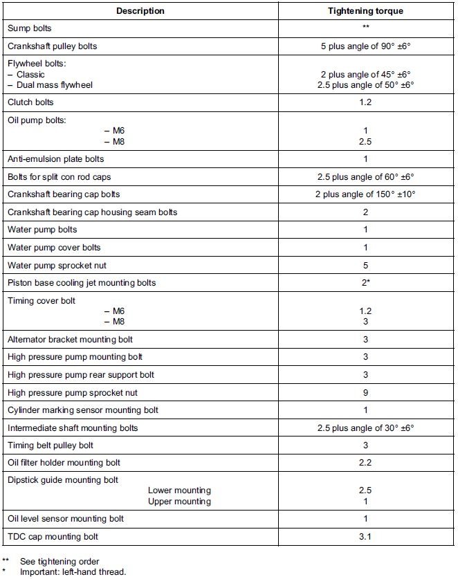

Hello.
I need the flywheel bolts torque settings in Newton meters. Nm.
Please. Thank you

Hello.
Furthermore to my question in regards to the flywheel bolts torque settings I need to point out which i earlier omitted.
The type of engine in the Renault master is a g9uc 754 engine.
Regards,
Apologies for the omission.

The image should contain the specs for both styles.

Mr Steve W.
Thank you for your reply.
Highly appreciated.
