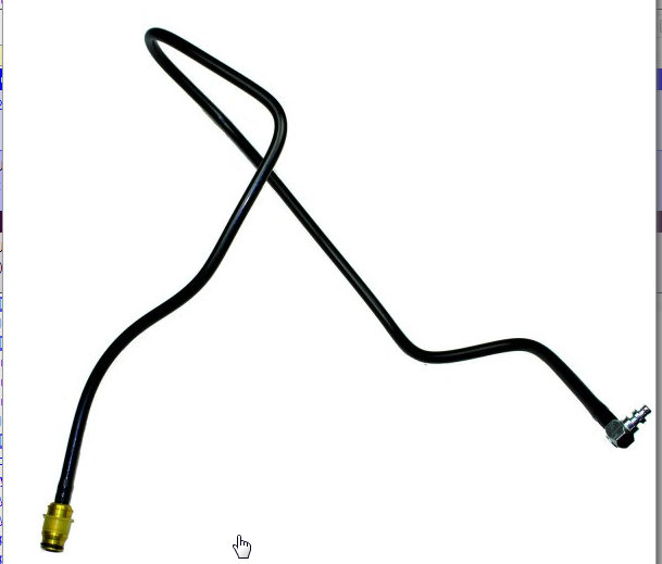

No clip to hold the line so do I undo it from the reservoir?
Oct 30, 2019 at 2:51 AM

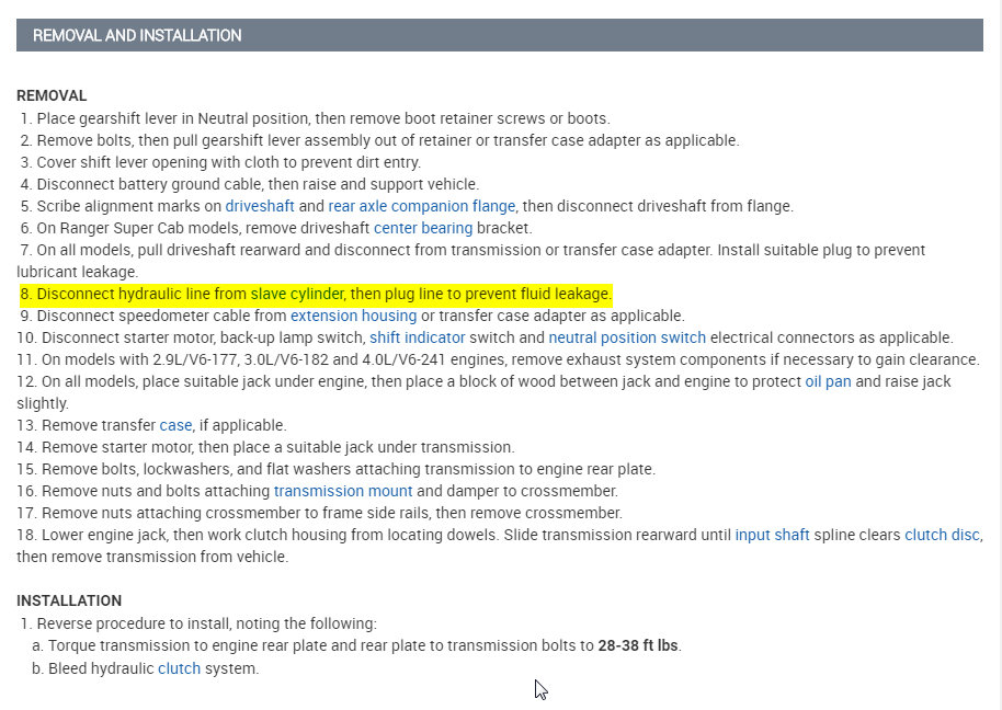

I am not sure which fluid line you are talking about other than the clutch hydraulic line. I attached the procedure and it says to detach it from the slave cylinder. Let me know if you are talking about a different line. Maybe get a picture of it and that will help. Thanks
Oct 30, 2019 at 10:11 AM
MIKE TKACHUK
The truck is 2WD and the hydraulic line goes through the bell-housing to the throw-out bearing. Does it have a clip like a fuel line?
Oct 30, 2019 at 12:08 PM

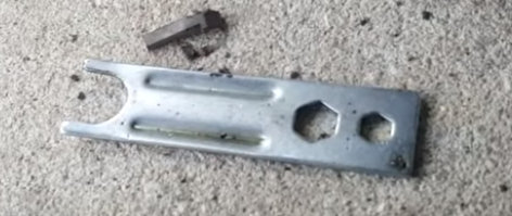

Okay. I assume you mean the line to the slave cylinder because these can be difficult. Here is a picture of the tool that you need to use. The fuel line tool will not work.
