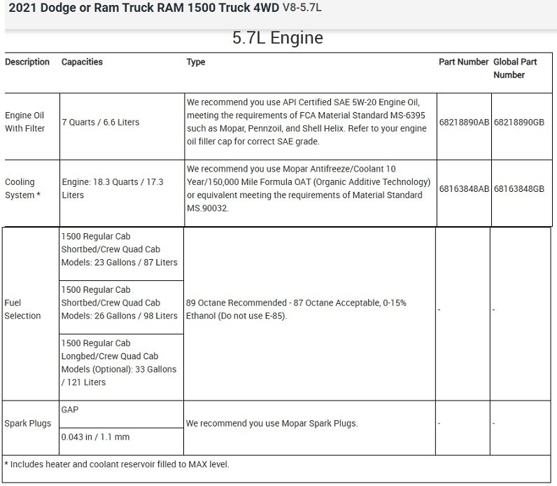

I can share my experience with a very similar 2014 Ram 1500. The coolant is listed as good for ten years. It is alcohol and will always be alcohol. It's the additives, like anti-corrosion agents, seal conditioners, and water pump lubricant that wear out. It becomes acidic from combustion gases that naturally sneak into the cooling system. The additives neutralize that.
Those additives in engine coolant used to wear out in about two years, so that was the recommended change interval. Some new coolants advertise "lifetime", but I'm not sold on that. "Lifetime" means different things in different states. For example, here in Wisconsin, if you buy a "lifetime" warranty for your new vehicle, that is considered 14 years. You won't get the free engine you expect after 20 or 30 years.
Check your owner's manual for the fluid change recommendations. I'd be surprised if it isn't listed as "10 years".

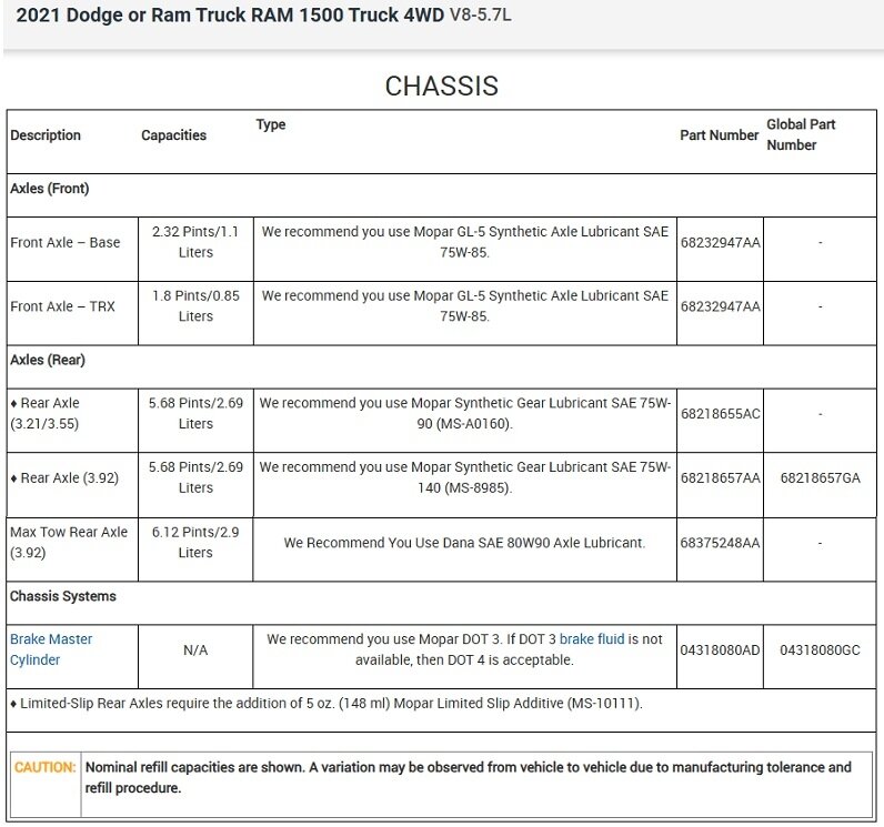

Forget the brake fluid change. That is a very real service, but almost everyone ignores it or isn't even aware of it because the brake hydraulic systems cause such little trouble. The concern is brake fluid loves to absorb moisture. That occurs through the rubber flex hoses and when a container of new fluid or the cap on the reservoir is left loose. That moisture promotes the corrosion of metal parts from the inside, but it also leads to one type of brake fade. Brake pads generate a lot of heat, especially in city driving. That heat migrates through the pads and caliper pistons, then into the brake fluid. Brake fluid boils at well over 400 degrees F. Moisture boils at 212 degrees. It's pretty easy for brake parts and fluid to get that hot, then the moisture vaporizes, developing air in the fluid. Since air can be compressed, it causes a low and spongy brake pedal. It can also prevent the anti-lock brake system hydraulic controller from performing properly. It's normal for brake fluid to turn dark over time. That's a result of being heated multiple times. We want to replace brake fluid periodically to get the moisture out. If you have nothing better to spend your money on, have the brake fluid replaced every 50,000 to perhaps 75,000 miles, since you put on so few miles per year. This is more of a time thing rather than a mileage thing.
If your truck is a 1500, it has a rack and pinion steering gear with electric power assist. You'll see there is no belt-driven power steering pump on the front of the engine. This doesn't even show up in the specifications. I posted some fluid charts but they don't include the recommended change intervals.
