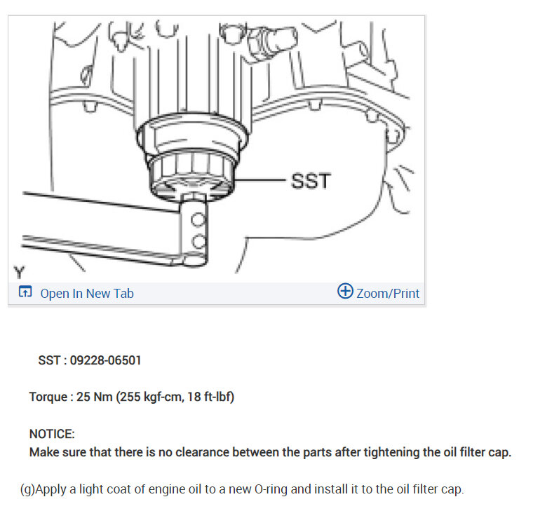

I just got this vehicle at 128,000 and I want to change all the fluids. Brake, Engine, Transmission, Differential and transfer case. Is there any specific information that I need to know?

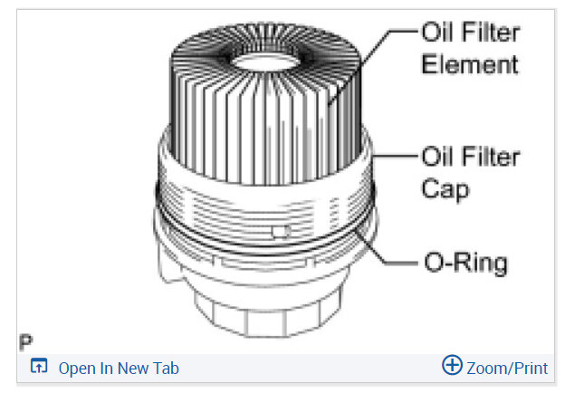

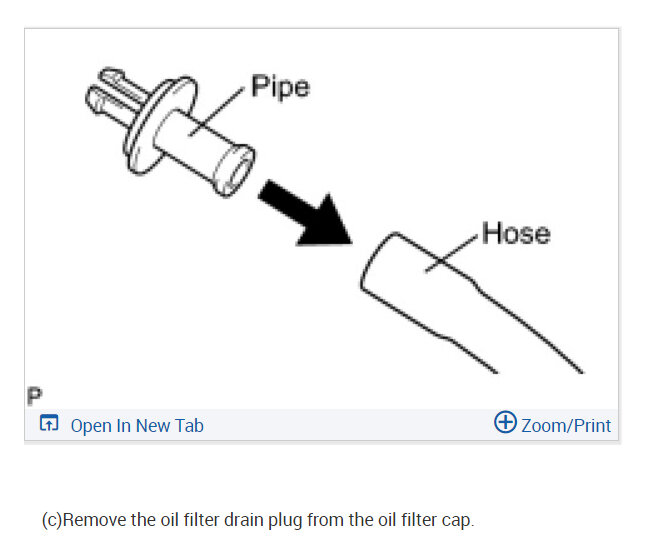

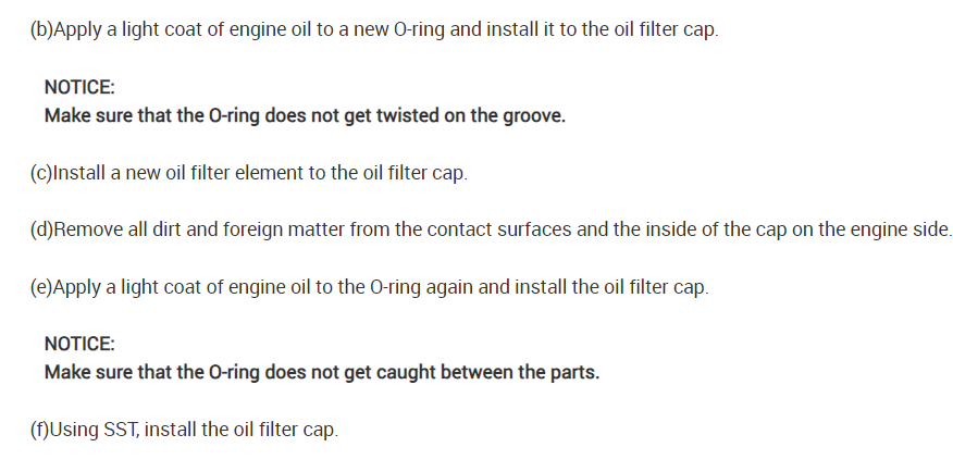

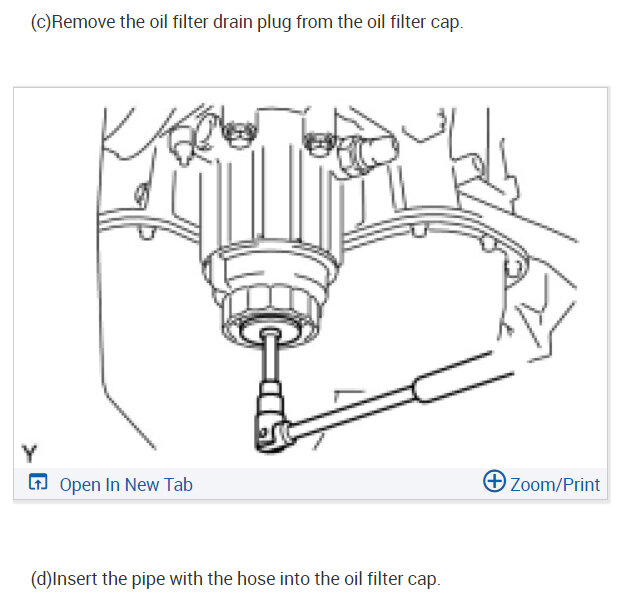

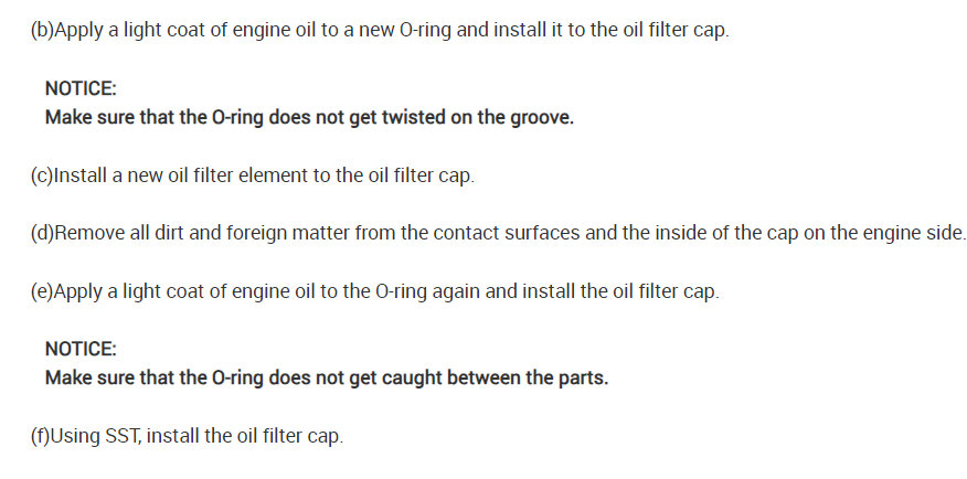

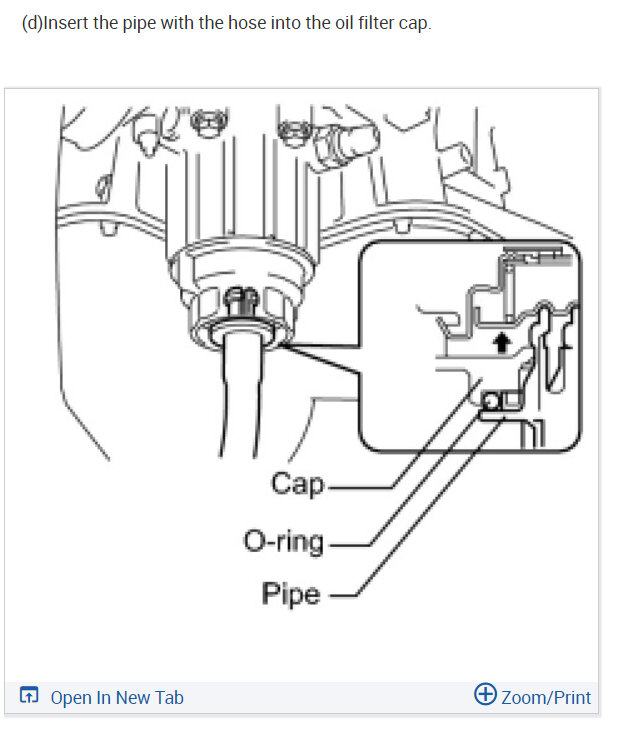

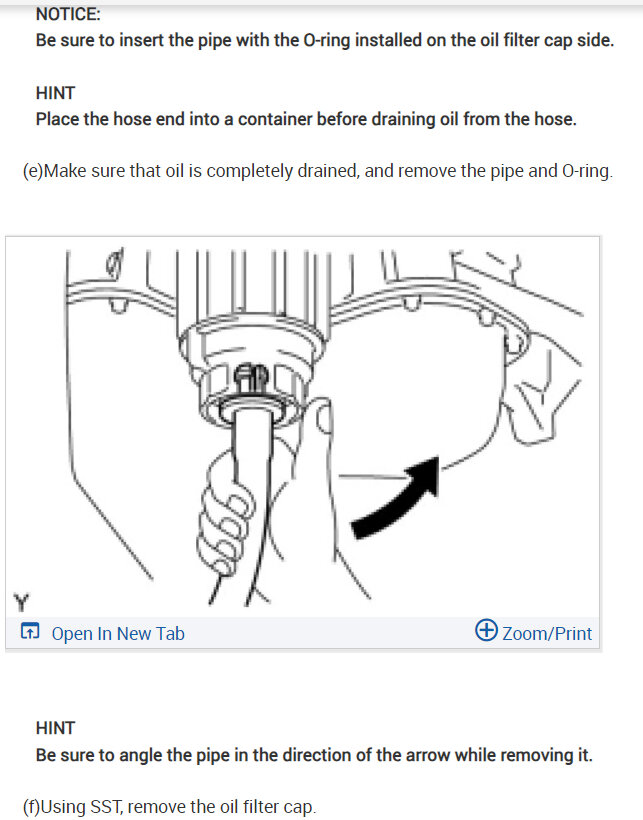

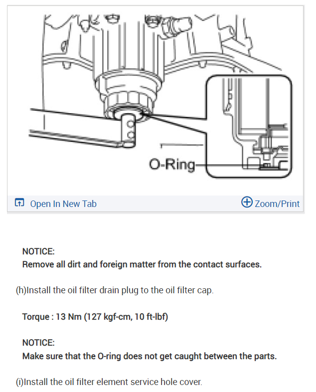

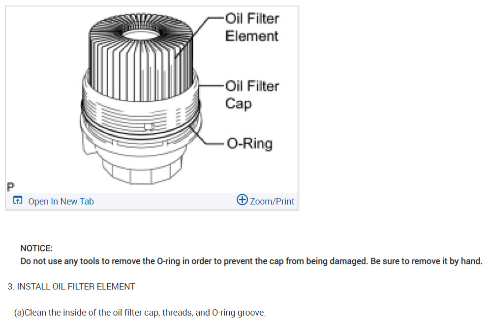

Yes, we can help you with the engine oil change on this thread you can you ask separate questions on the other fluid changes? We only handle one problem per thread.

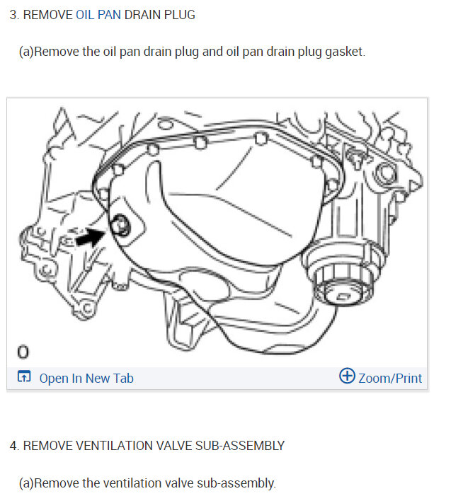

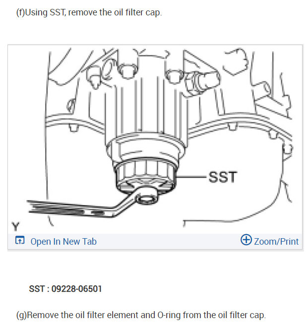

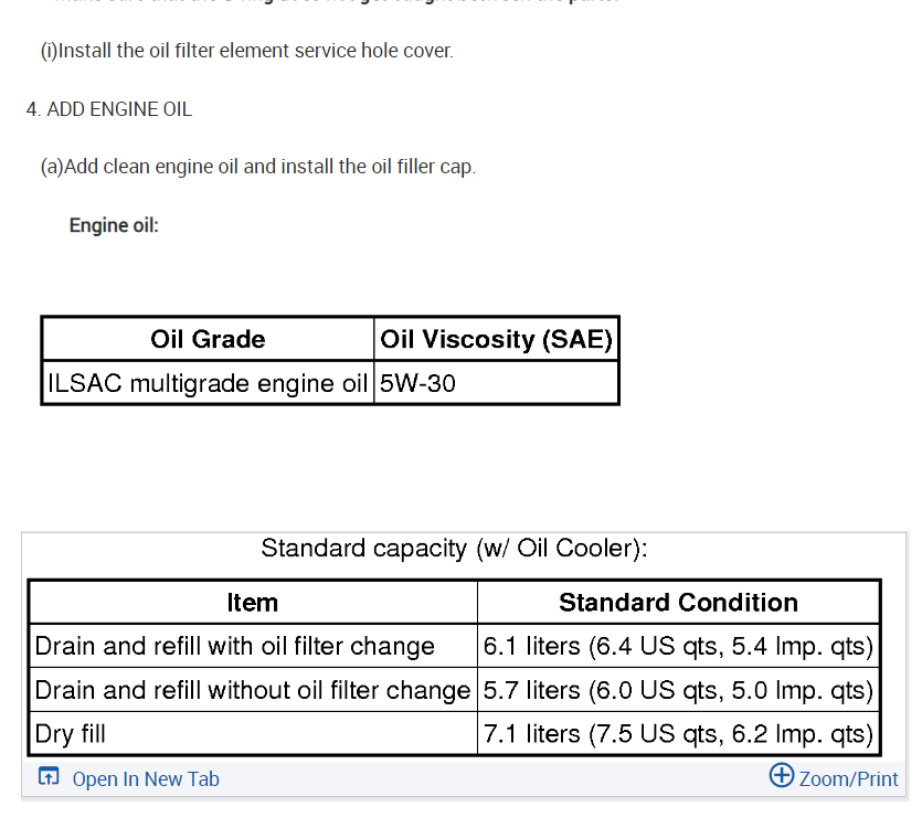

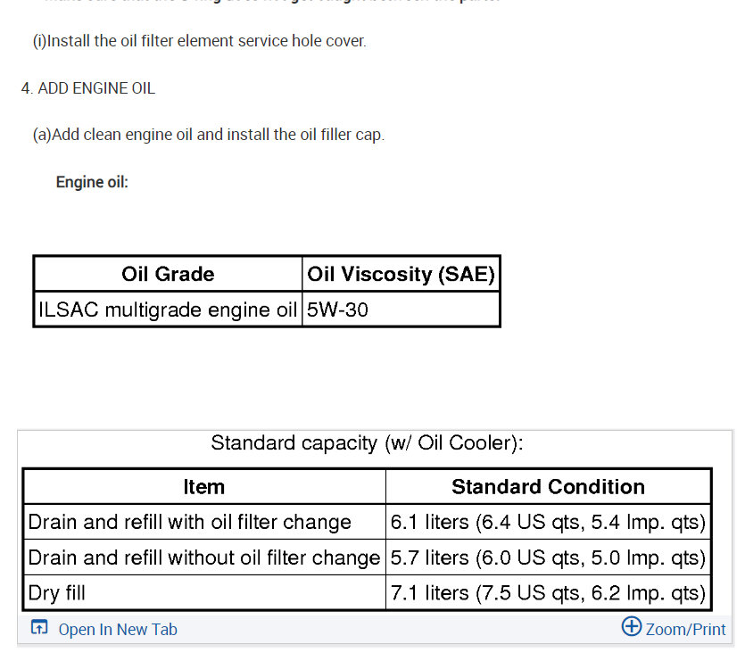

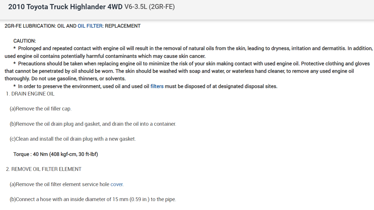

Here is how to change the engine oil and filter with the recommended oil weight:
Fluid Types
Engine Oil Type
Grade .................... ILSAC multigrade engine oil
Viscosity:
With tow package .................... SAE 5W-30
Without tow package .................... SAE 5W-20

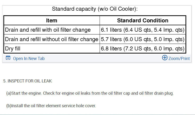

Capacities
Engine Oil capacity (drain and refill)
With filter: .................... 6.4 qt(6.0L)
Without filter: .................... 6.0 qt(5.7L)
Check out the images (below). Let us know if you need anything else.
