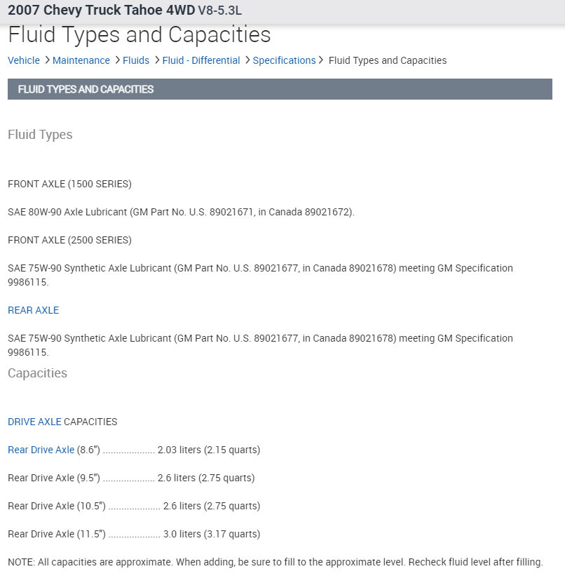

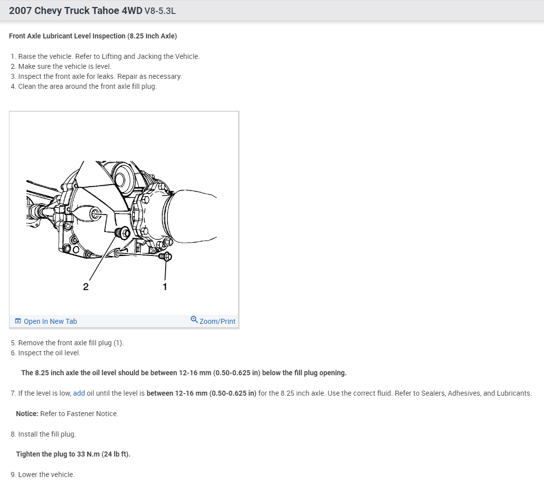

Front differential- owner manual states 80w 90 gear lube - I found service bulletin PIP372D Nov. 2012 that states:
14. Myth: Synthetic fluid cannot be used in front axles on T-trucks and L-vans. The seals are not compatible and could also cause bearing failure. False -- Synthetic lube can be used in all new American Axle Manufacturing Assembly.
Can I use 75w 90 full synthetic in front diff?

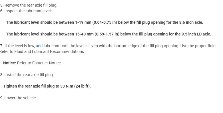

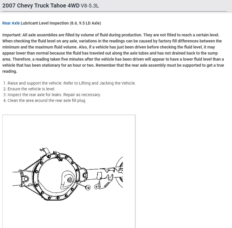

Rear differential: should I remove the back plate to drain fluid and clean? No noise from front or back differentials, just trying to get another 100,000 out of this truck.

Yes, you can use 75W-90 in those differentials.
Unless you have concerns about metal shavings or gunk, no need to remove the cover and clean.
Is your transfer case the Auto or the manual one?
I have attached the fluid change procedure as well as the capacity below for your reference.
Let me know of any questions.
