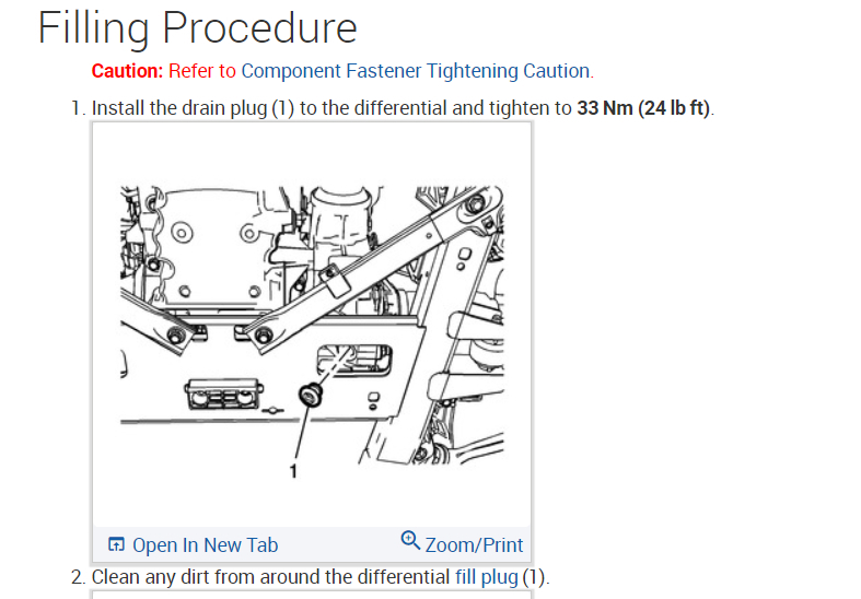

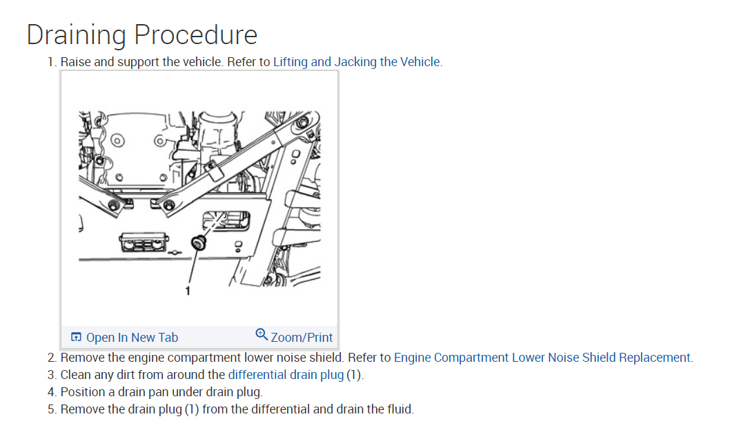

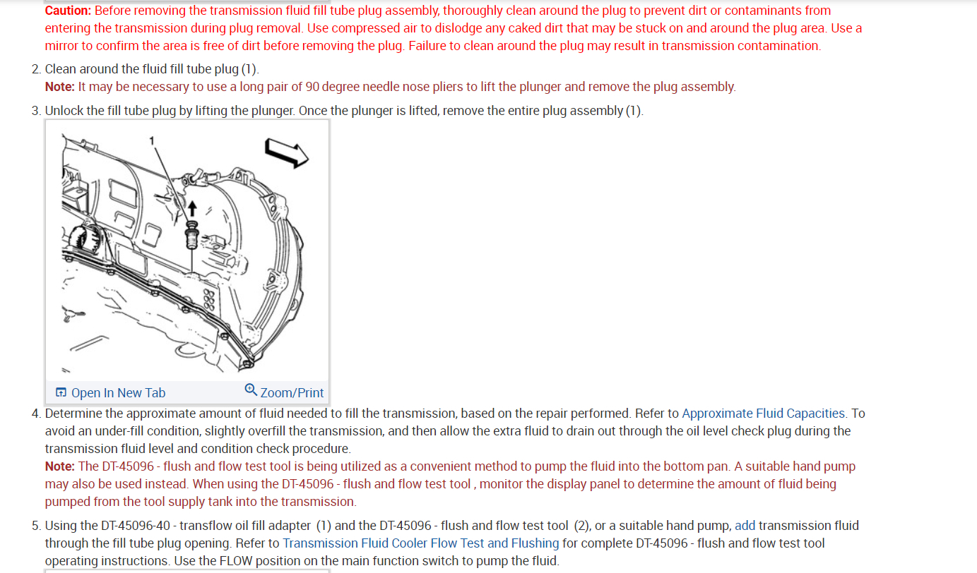

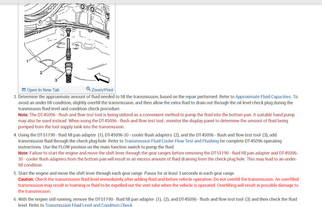

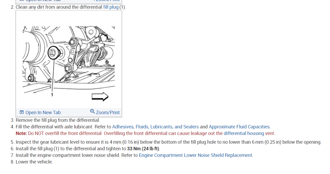

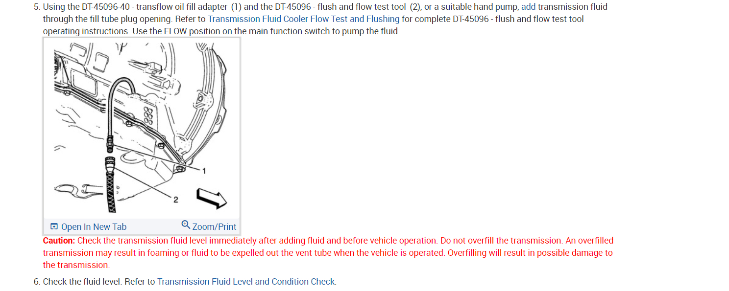

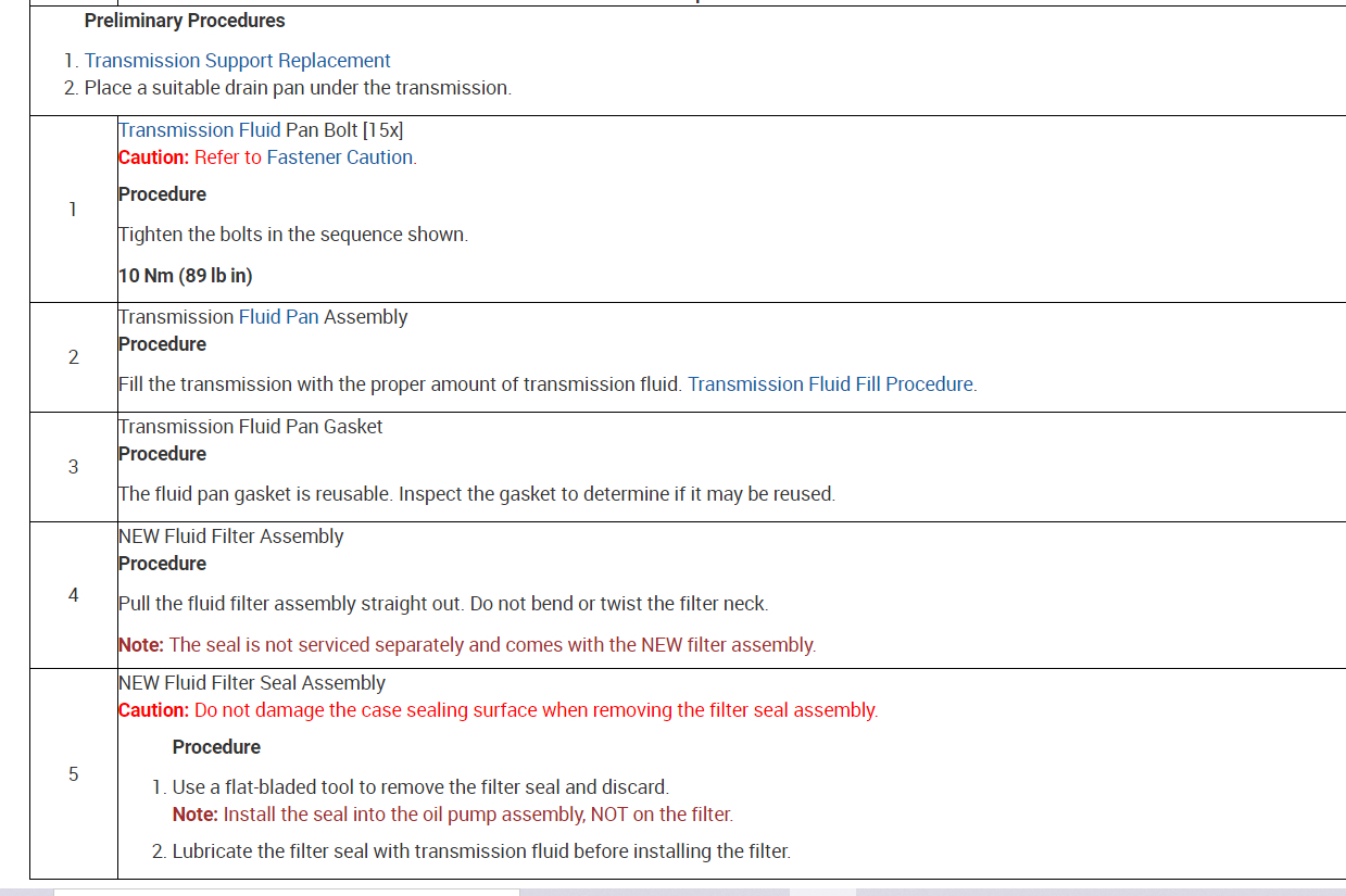

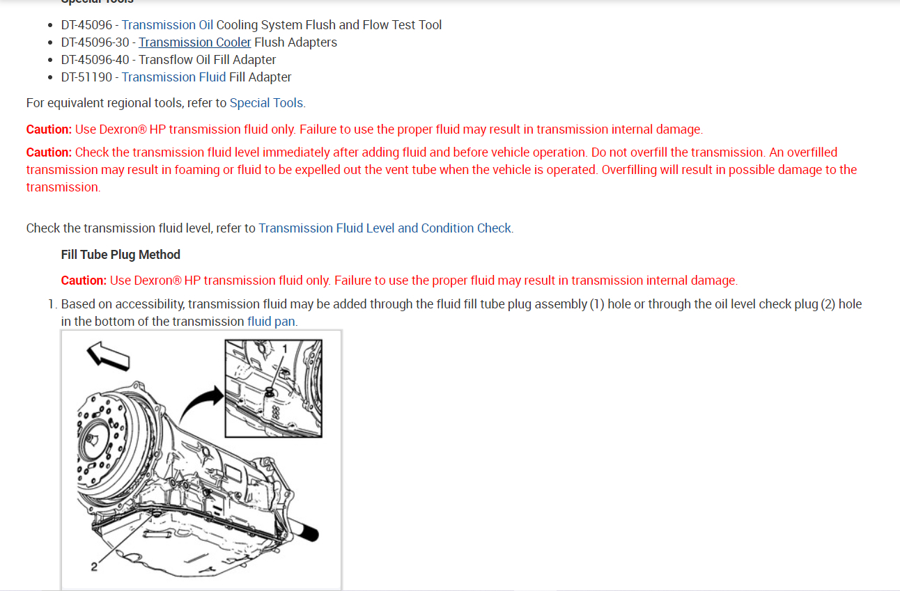

I am preparing to change the front and rear differential and transfer case and transmission fluid. Would you be able to provide the instructions and pictures that will enable me to perform this correctly? Thank you.
May 9, 2021 at 8:44 AM
  • CAR REPAIR CONTRIBUTOR
Good evening,
I attached procedures and pictures for you below. The front and rear differentials are the same.
https://www.2carpros.com/articles/differential-service

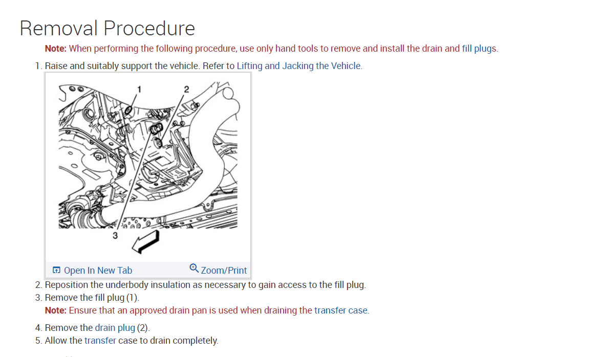

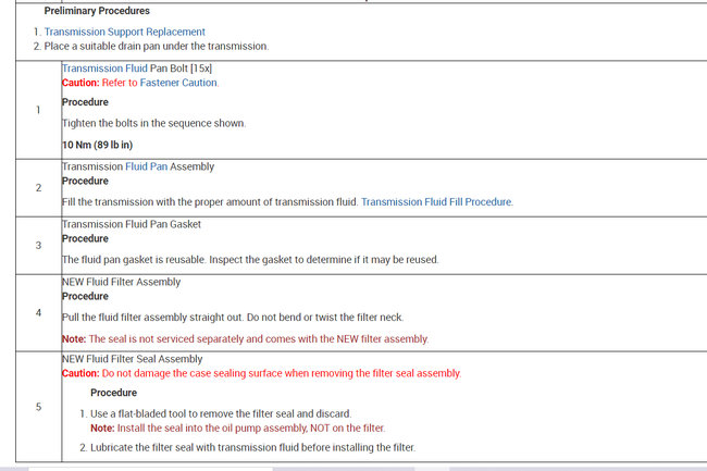

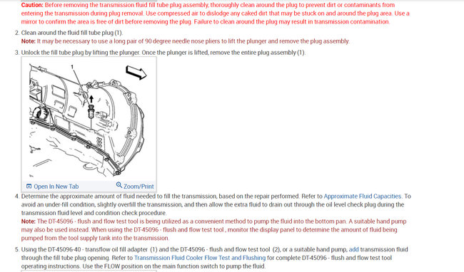

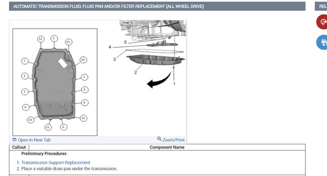

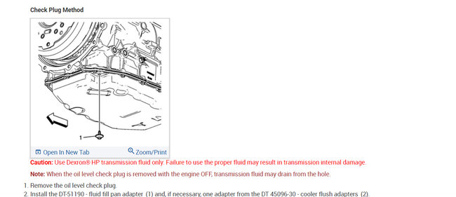

The transfer case and transmission are attached.
May 9, 2021 at 8:50 PM
SIRJR
  • 86 POSTS

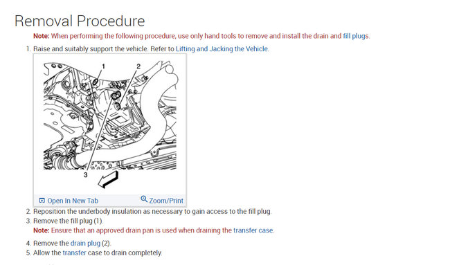

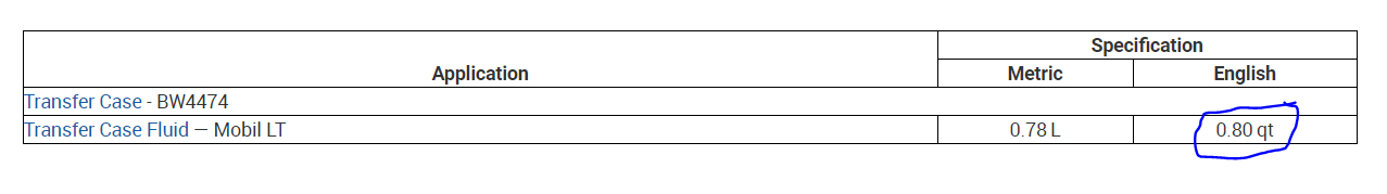

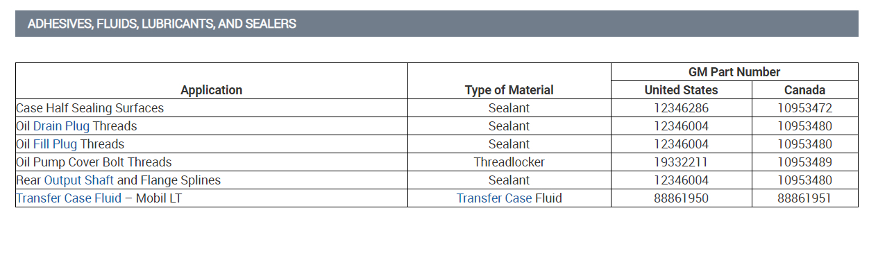

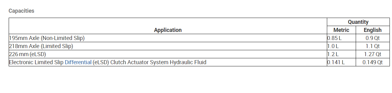

Thank you very much for all the detailed pictures. I have a question regarding the 7th picture of the transfer case. There is a #3; however, there is no mention of this in the diagram. Also, do you have the fill capacity of the transfer case? Thank you, Steve
May 10, 2021 at 5:48 AM
Number 3 is a switch. You may or may not have this.
I attached the capacity for the transfer case below.
May 10, 2021 at 5:58 AM
