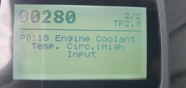

Hello. I have a fluctuation in the water level gauge and I just changed the coolant sensor and still does that. I read somewhere that if the fluctuation is to fast it can only be from that sensor, but you never know. Any ideas?

Hi. Actually no, the car doesn't overheat. I only changed the coolant sensor, and the coolant is full. I have video of the movement. Also, I used some OBDII because I got the engine light and I have attached photo. This is why I changed the coolant sensor.
Jul 30, 2019 at 9:45 PM
  • 110,240 POSTS
Welcome back:
There is a problem in the wiring. Check to make sure connections are clean, tight, and not corroded.
