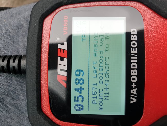

JAY JACKSON
  • 6 POSTS
Hi Joe, I purchased a code reader and it is saying that both engine mounts need changing, so I think you are spot on.

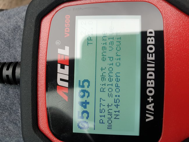

JAY JACKSON
  • 6 POSTS
Hi Joe, did a scan and this is what came up.

JOETECHPRO
  • 705 POSTS
Hey JAY JACKSON,
I would say still check the engine mounts for leaks and replace if leaking.
It looks like the solenoid is part of the mount.
There will be an electrical connector on the top of the mount, If you don't find any leaks ensure these connections are plugged in correctly.
From what i can see the motor mounts going bad is fairly common.
You could also look into replacing the mounts with a solid non fluid filled mount, the fluid filled solenoid mounts may be quite expensive.
