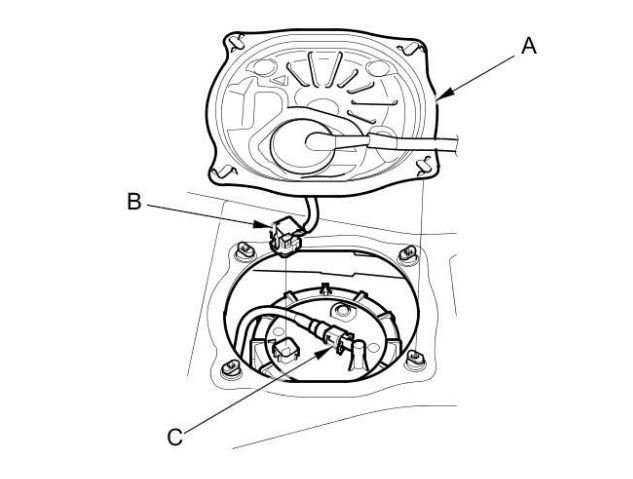

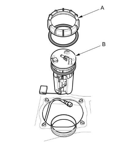

I would start by changing the fuel. You have vents and most likely water got into the fuel tank and is causing issues.
I would change the oil as well. Never assume it is okay with high water.

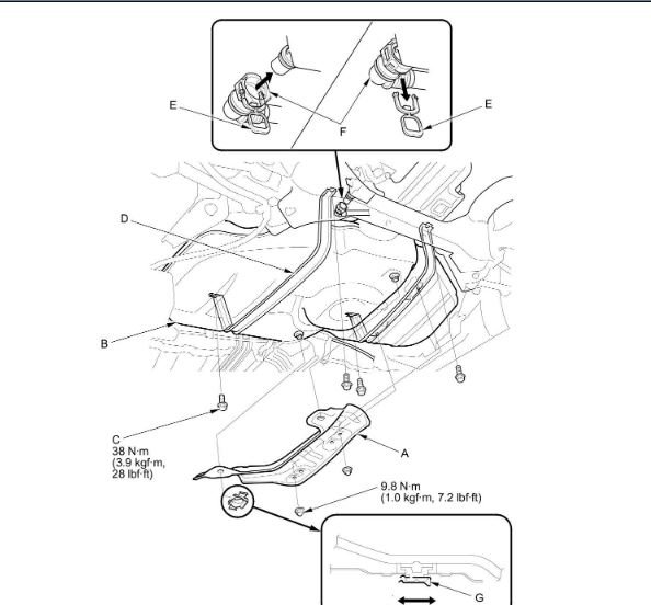

Tank draining requires tank removal
Fuel Tank Draining
1. Remove the fuel tank unit See: Fuel Pump > Removal and Replacement > Fuel Tank Unit Removal/Installation.
2. Using a hand pump, a hose, and a container suitable for fuel, draw the fuel from the fuel tank.
3. Reinstall the fuel tank unit.
